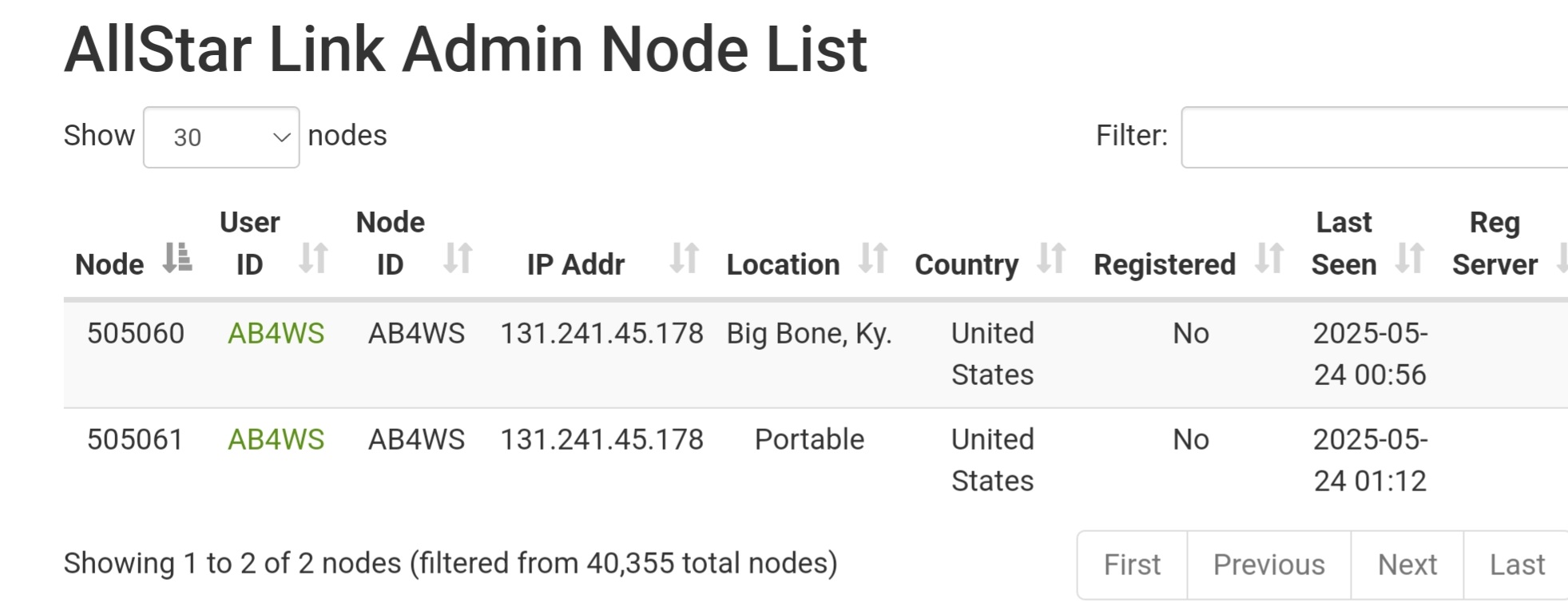

I have a couple allstar Nodes working fine, but all of a sudden today my M1KE quit working on ALLSTAR. Will not connect to any node. Several others I know with the same device are experiencing the same issues. All worked prior to today but not connecting today.
Any ideas, suggestions etc???

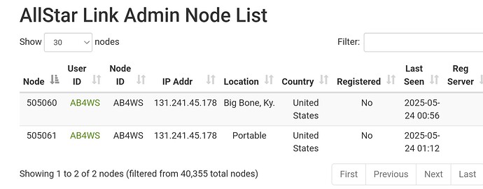

I show both of your node numbers as offline.
I'm able to connect to my nodes and at least two random others in WT mode (what you're using, I assume).
EDIT: Now showing back up; I was able to make a normal my node-to-your node connection but still no WT. (And I checked; WT is enabled in your portal).
It appears that perhaps one of the registration servers was locked up. I believe I found the culprit and restarted it. Let me know if this is continuing.
I was able to connect with no issue and been good ever since. Others I know have also been able to connect as well using their devices.
