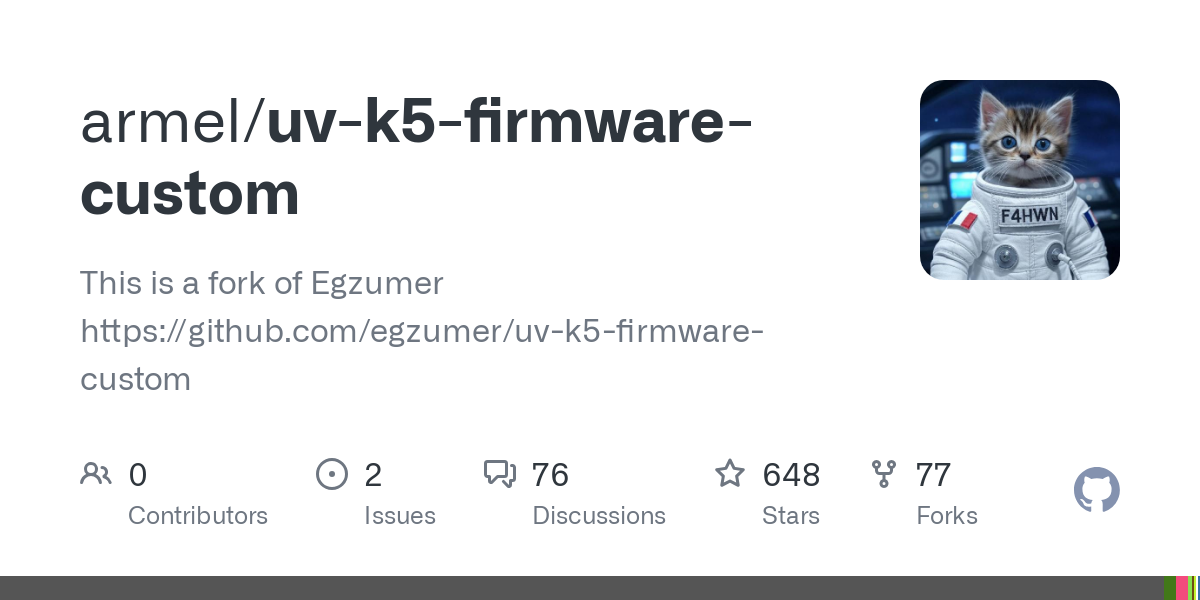

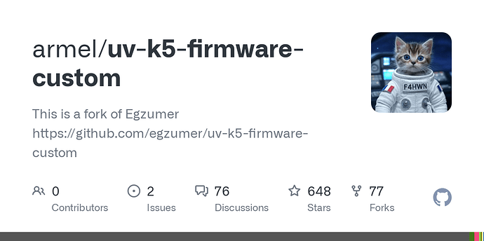

firmware is :
main github page for this custom firmware:
