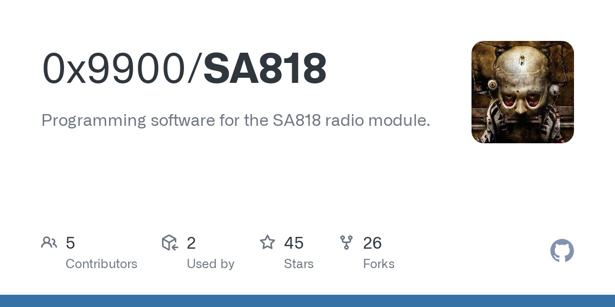

Maybe you can try use software for SA818
whre is option:
--tail TAIL           Close CTCSS Tail Tone (Open/Close)
