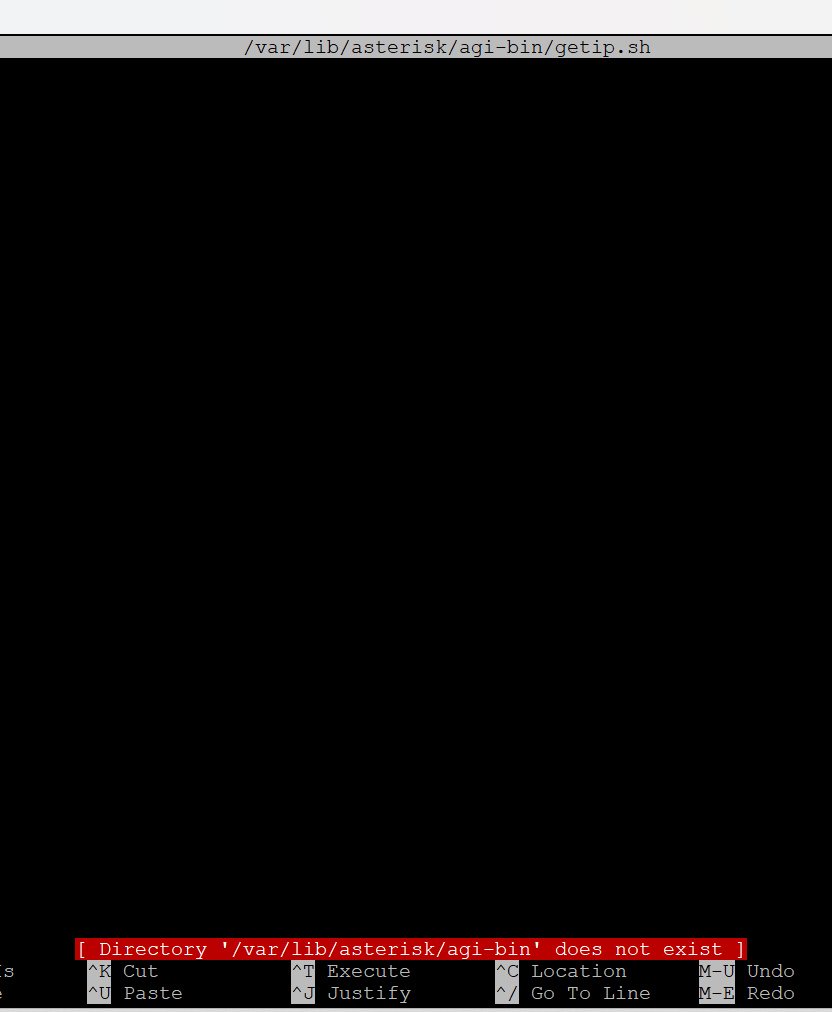

Thanks! don’t know why but i can’t get by the sudo nano /var/lib/asterisk/agi-bin/getip.sh with this method.
this is on a 3080 and tried on a few of them.
Ok…this worked perfectly. really appreciate it.
It appears that /usr/share/asterisk/agi-bin/ is actually where you want to put AGI files, not /var/lib/asterisk/agi-bin/. Not sure where the latter came from, that may have been for ASL2. Will update my above comment with this correction.
