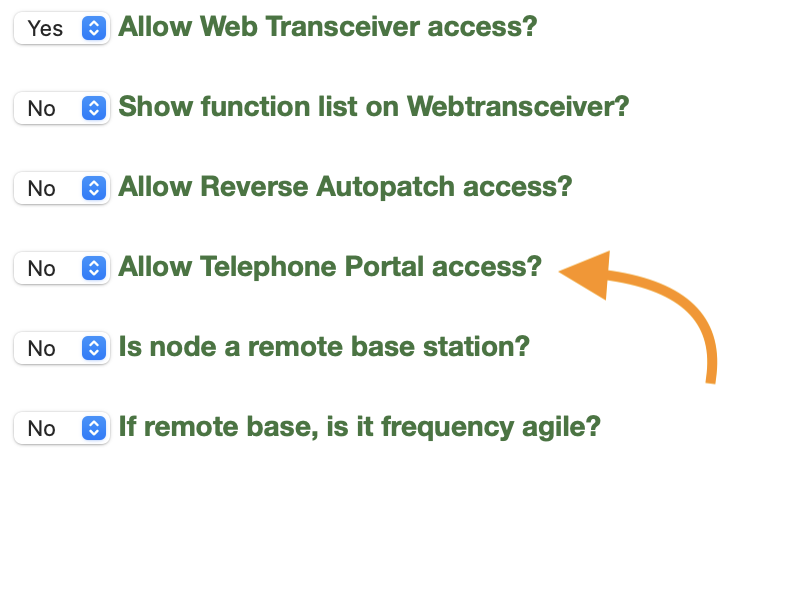

You must allow access to you node to use the telephone portal. Logon to allstarlink.org, go to you node settings and insure access is set to yes.
Thanks, it has been so long since I set up the node for the club (52883) that I forgot to ask the owner of 55588 to make sure phone was allowed. I’ve sent him an email to check it for me and hope that is it. When I did our club node we did it all worked quickly.
