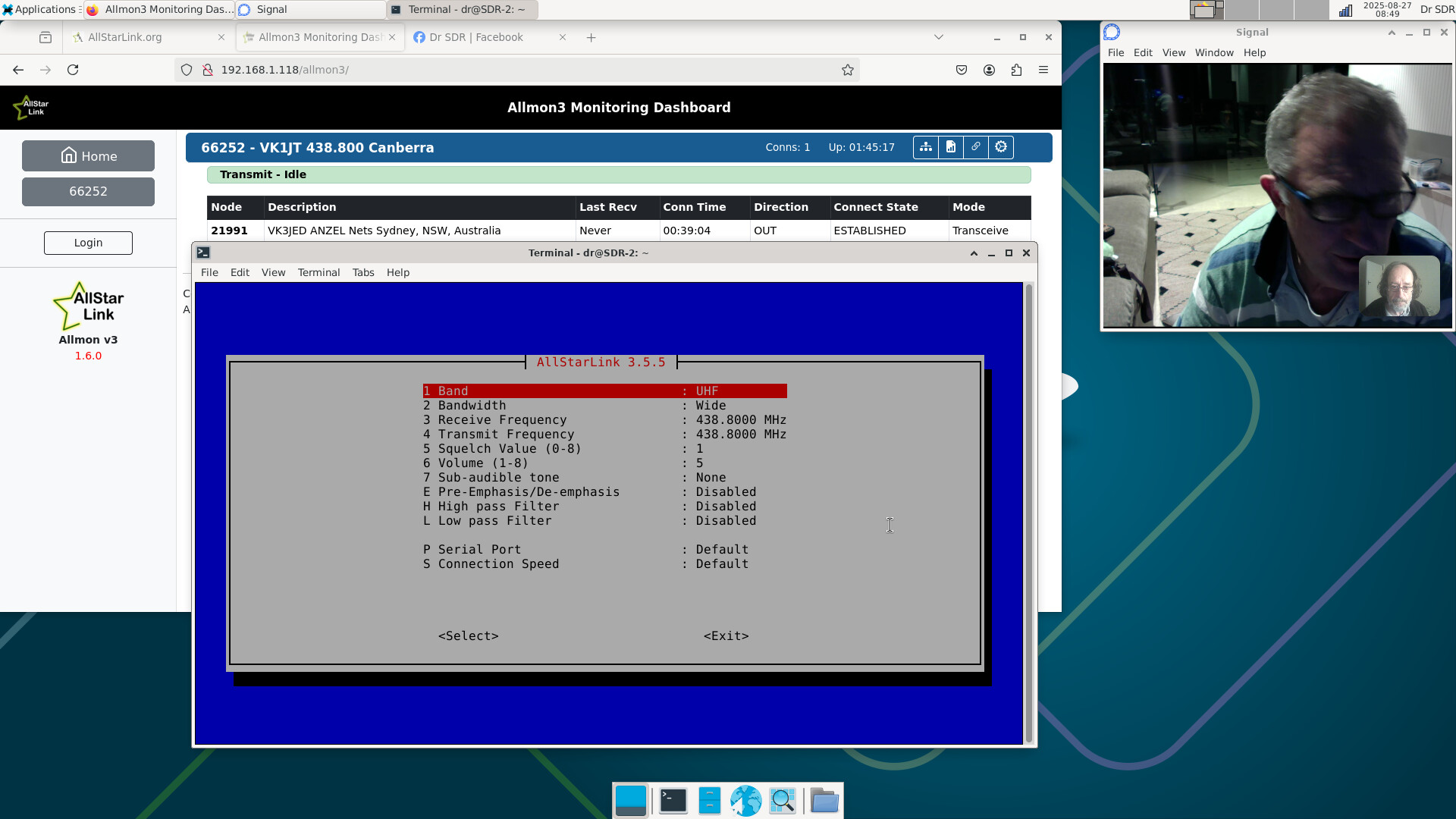

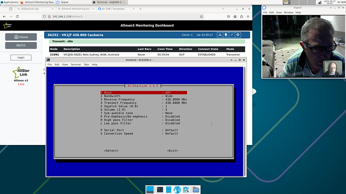

I have Trixie and asl3 running on my desktop after my Pi shat itself. Bit of fiddling but all good in the end.
Thanks to those that made this possible.
VK1JT / Dr SDR (fb).
