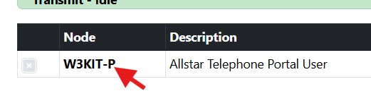

I created a node and set up an IAX account with [W3KIT] in the iax.conf.
At any rate when I connect my DVSwtich mobile to it my callsign is showing on the almon3 in the node column as W3KIT-P
Where did the -P came from? I checked iax.conf again and there is only one [W3KIT] in it.
I check my DVSwitch setup and in the username field I only have W3KIT which is matched with username in iax.conf.

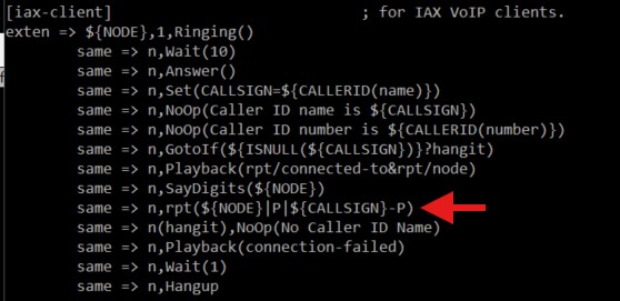

I think I see now where is -P came from.
I think it from extensions.conf
