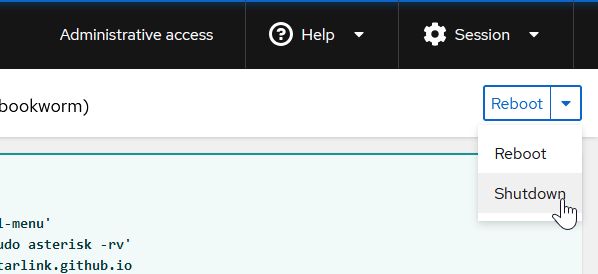

I’m not sure what you’re referring to about arrow keys. Shutting the node down is here:
Thankyou. Totally missed the reboot/shutdown box top right of Web Admin Portal screen after login.
All sorted now.
