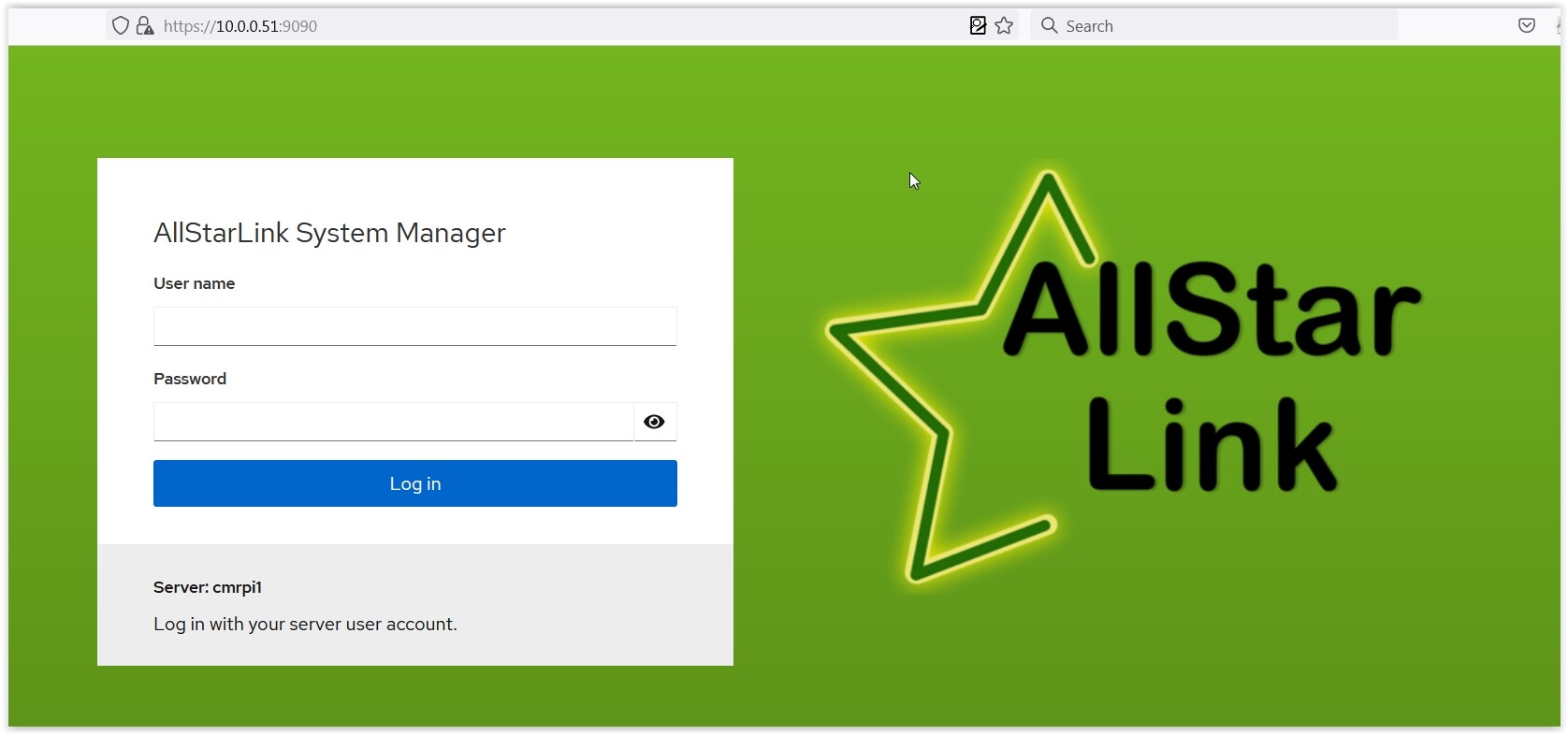

This is why I referred to port 9090 as allstarlink: when I got to that web page port up comes the login page for AllstarLink! Nothing here about Cockpit.

That is the login page for Cockpit. It doesn't say so because of the ASL custom page. You want to connect to port 80 (http) or 443 (https).
Ahhh - got bit by "branding"... the graphic on that page says "AllStar Link" because by default many will not use allmon... but that is the Cockpit login page as others have noted. The graphic is simply someone's idea of branding it for new folks...
(Cockpit is a generic tool available outside of the ASL world, and usually a "company logo" or similar goes there.)
To get to allmon3, using the IP from your screenshot, go to https://10.0.0.51/allmon3 -- if you IP changes, of course use the current address.)

The graphic made you say you were on an "AllStar Link" page, confusing helpers... kinda to be expected, I guess... Grin... which is why screenshots are often important...
