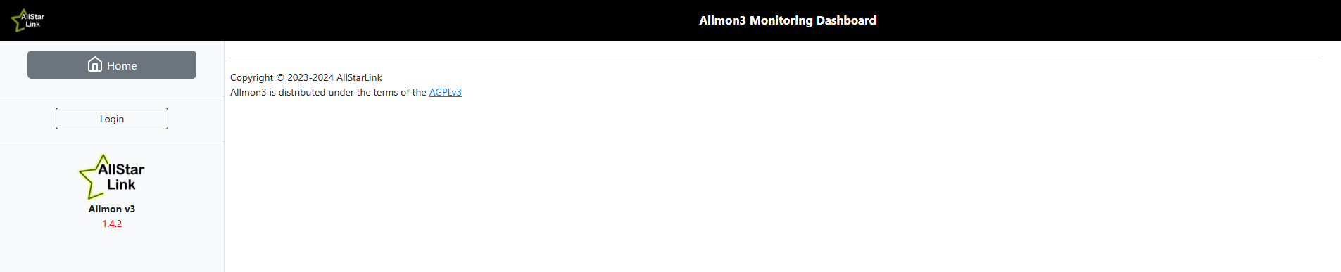

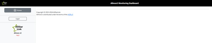

Please the following contents at /var/www/html/index.html:
<meta http-equiv="Refresh" content="0; url=/allmon3/" />
Sorry, do i have to put the string in that folder?
Edit the file /var/www/html/index.html and put that single line as the only contents of the file.

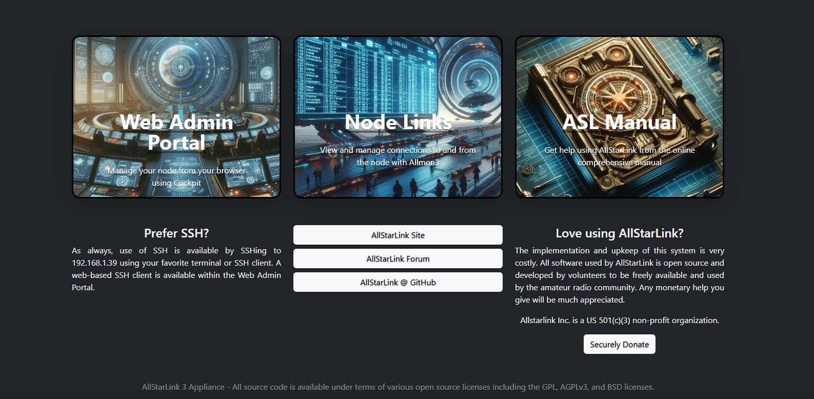

Hi, thanks.
I added the line it seems to work but the homepage is different from the ones i have on my raspberry PI. May we have the same?
Finally, it could be helful to add this tip on the guide to who is not so skilled like me :slight_smile:
Look at what i have just said:
The Pi Appliance is different than installing on a generic Debian OS. You can install the asl3-pi-appliance package and you’ll get everything that comes with the appliance. There’s a few things that don’t work right because it’s not technically supported on non-Pis.
