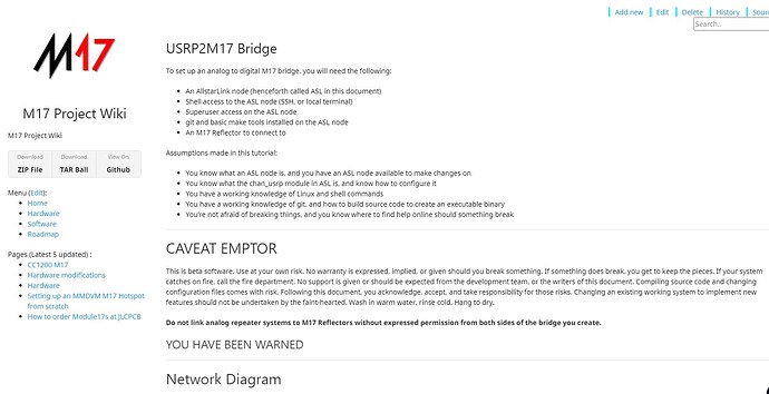

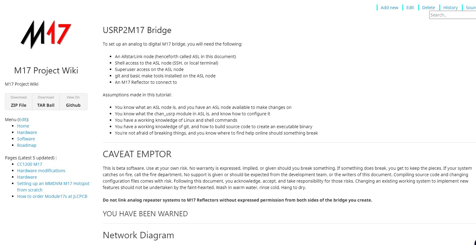

DMR bridge to M17? Do you by chance have examples of the file/s?
Rob - K6IRK
Hi Rob, its ASL <=> DMR
| <=> M17
I used this guide
KC1JFN
Thank you so much.
Did you have to do the entire part, or just the ASL Part where it says Start ASL?
Thank you again
Rob
Hi Rob, when you open the link it should start on the screenshot I attached.
KC1JFN
