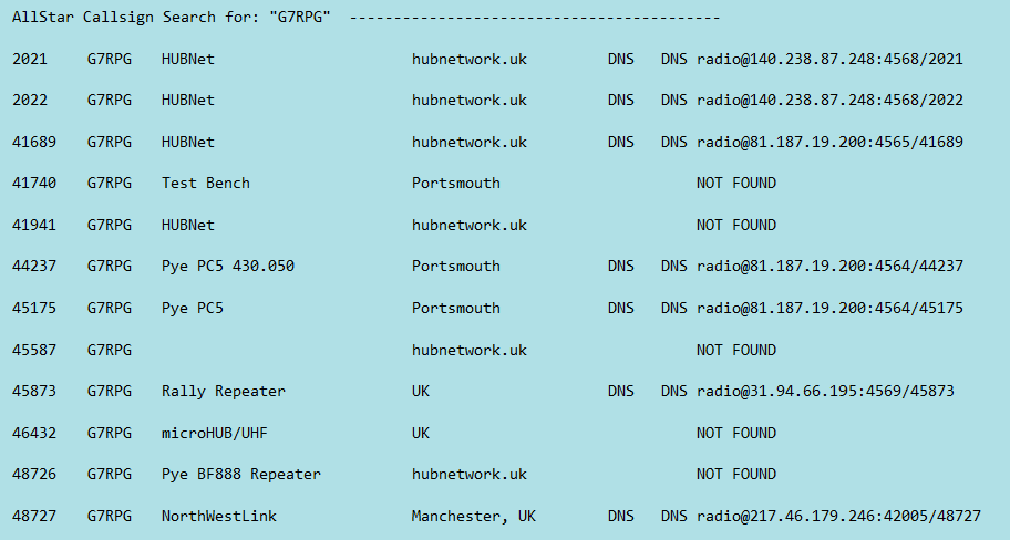

depending on the Node you are talking about depends on if you are connected or not. if it is logged in ok then it pulls an updated list. if not then you will not get a list. here is a list of you hub nodes.
