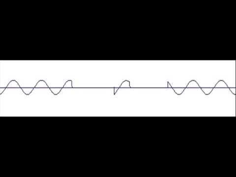

Here's a youtube video of the popping I describe from the USB device:
If you have the patience to actually listen to about 3 minutes of 100Hz PL and the once per minute CWIDs you'll hear the audio
dropouts I am talking about..
Also a look on the scope (you'll also see it in that video) the audio is actually completely dropping off like cpu is elsewhere and the stream is not being processed for
short bursts of time but very randomly and sometimes not for over a minute at a time!

    The popping very much sounds like an interrupt issue or some kind of
issue where the task of sending and audio stream is completely dropped
for something else
and then resumed leaving lots of holes heard as pops in the output stream.

    The popping very much sounds like an interrupt issue or some kind of issue where the task of sending and audio stream is completely dropped for something else
for something else

Hello David... I *may* also be on to something here as I've been able to
also determine that the audio pops are occuring ALWAYS
While app_rpt is doing it's statpost routine! updating stats via the web.
I set te statpost address to something local on the LAN for now just for
testing but I get the same audio pops whether just on the
LAN or if it's statposting out to the internet.
The popping definitely happening at the time that app_rpt is sending
HTTP out..
The popping never happens during other access to-from the ethernet or
during IAX interchanges between asterisk and the world..
Seems to be only when app_rpt is stat posting...
Dave I think you are certainl correct about the issue being within app_rpt.
I'm sure the stat posting is not the only issue but I can duplicate the
problem 100% by seeing the popping every time app_rpt
sends out HTTP. :slight_smile:
You may have already found that app_rpt does the 'droppouts' with a ton
of other activities... not just stat posting like I am currently
pointing out...
Might be a start to something though... since it's duplicatable here. :slight_smile:
