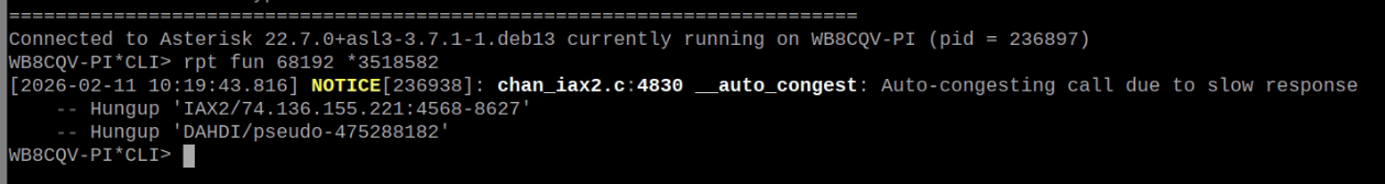

Folks I get this error with I try to connect my Node 68192 to my friends nod 518582
Connected to Asterisk 22.7.0+asl3-3.7.1-1.deb13 currently running on WB8CQV-PI (pid = 66447)
WB8CQV-PI*CLI> rpt fun 68192 *3518582
[2026-02-09 10:35:42.801] NOTICE[66480]: chan_iax2.c:4830 __auto_congest: Auto-congesting call due to slow response
-- Hungup 'IAX2/74.136.155.221:4568-3225'
-- Hungup 'DAHDI/pseudo-163676563'
WB8CQV-PI*CLI>
I need some help to resolve this problem. My internet speed is typically 900MB when checked with speedtest. I have tried to connect to other nodes with similar errors.

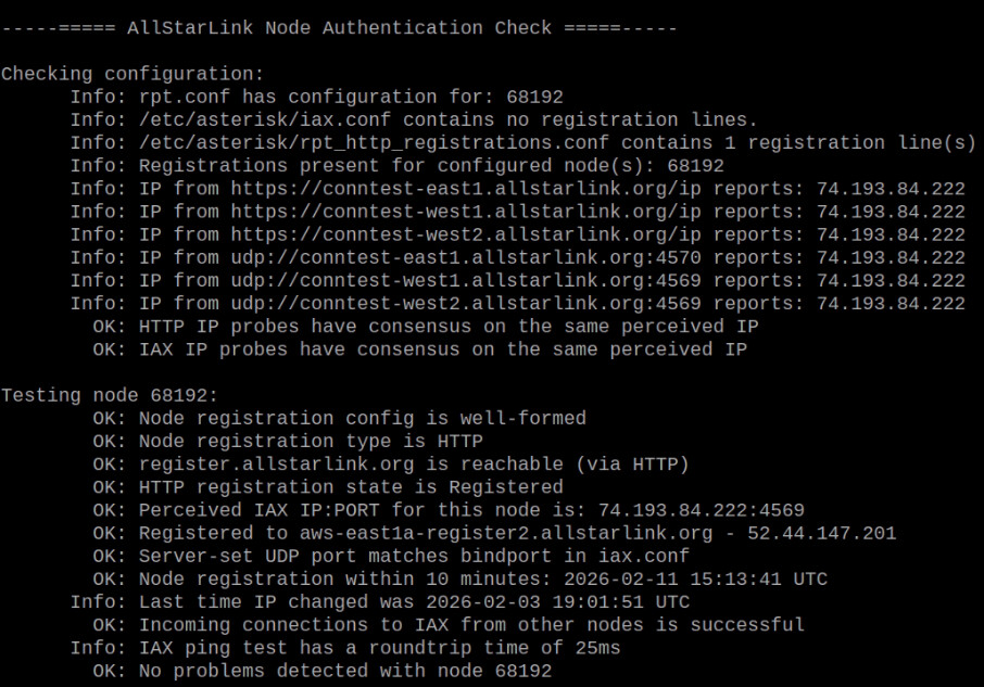

That almost always means your node isn't properly registered. If it is, then the other issue is something is blocking the networking between your node and the remote nodes.
I've added a new tool to the asl3 package that's currently in beta. If you're comfortable doing it, try installing the beta asl3 package:
sudo asl-repo-switch -l beta
sudo apt update
sudo apt install asl3
sudo asl-repo-switch -l main
That will give you a new tool I've been developing - asl-node-auth-check that will test your node's authentication, registration, and reachability. Here's an example:
# asl-node-auth-check

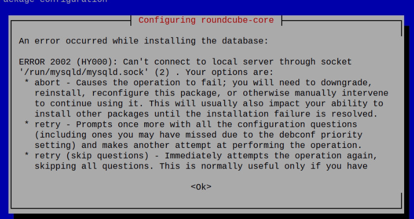

Is this an ASL3 appliance? Roundcube is a webmail server. That message is telling you the database isn't setup correctly for Roudncube. It's irrelevant to ASL3. Can't even guess how you got that.

Here is the result of asl-node-auth-check:
And here is the result of trying to connect to my friend node:
I hope this gives you a little more insight.
John, WB8CQV
You node is fine, I just connected to it. Node 518582 is not responding to incoming IAX2 connections. So the problem is on the other end, not your end.

[2026-09-08 17:01:48.339] NOTICE[871]: chan_iax2.c:4830 __auto_congest: Auto-congesting call due to slow response
[2026-09-08 17:02:16.340] WARNING[869]: chan_iax2.c:3645 __attempt_transmit: Max retries exceeded to host 104.232.32.242 on IAX2/104.232.32.242:4569-9916 (type = 6, subclass = 1, ts=3, seqno=0)
-- Hungup 'IAX2/104.232.32.242:4569-9916'
I would double check your port forwarding. While it does appear you're going out of your exit node; it doesn't seem to be able to make the incoming connection back in to your node through the exit node:

Compare that with my tunneled (and dockerized) node's output:
-----===== AllStarLink Node Authentication Check =====-----
Checking configuration:
      Info: rpt.conf has configuration for: 594080
      Info: /etc/asterisk/iax.conf contains no registration lines.
      Info: /etc/asterisk/rpt_http_registrations.conf contains 1 registration line(s)
      Info: Registrations present for configured node(s): 594080
      Info: IP from https://conntest-east1.allstarlink.org/ip reports: 144.172.124.240
      Info: IP from https://conntest-west1.allstarlink.org/ip reports: 144.172.124.240
      Info: IP from https://conntest-west2.allstarlink.org/ip reports: 144.172.124.240
      Info: IP from udp://conntest-east1.allstarlink.org:4570 reports: 144.172.124.240
      Info: IP from udp://conntest-west1.allstarlink.org:4569 reports: 144.172.124.240
      Info: IP from udp://conntest-west2.allstarlink.org:4569 reports: 144.172.124.240
        OK: HTTP IP probes have consensus on the same perceived IP
        OK: IAX IP probes have consensus on the same perceived IP
Testing node 594080:
        OK: Node registration config is well-formed
        OK: Node registration type is HTTP
        OK: register.allstarlink.org is reachable (via HTTP)
        OK: HTTP registration state is Registered
        OK: Perceived IAX IP:PORT for this node is: 144.172.124.240:4568
        OK: Registered to aws-east1a-register1.allstarlink.org - 52.21.169.197
        OK: Server-set UDP port matches bindport in iax.conf
        OK: Node registration within 10 minutes: 2026-09-09 21:40:02 UTC
      Info: Last time IP changed was 2026-09-03 00:51:52 UTC
        OK: Incoming connections to IAX from other nodes is successful
      Info: IAX ping test has a roundtrip time of 21ms
        OK: No problems detected with node 594080
Those last three lines are the important ones. I would check the rules on your digital ocean vps to ensure it's sending port 4569 over your VPN:

But I don't think that'll actually fix the problem you're having. You were directly connectable on the results you printed in February; so your ISP wasn't blocking ports.
Did you ever try any other nodes? I would make sure it's happening on every node you try before digging deeper. One node not working could be a problem with the remote node.
Thanks for the reply
I just tried with several nodes this evening with the same result.
I disabled the firewall on the machine for testing, no change.
I switched back to using the local router instead of the tailnet, no change.
I'm not sure where else to go
