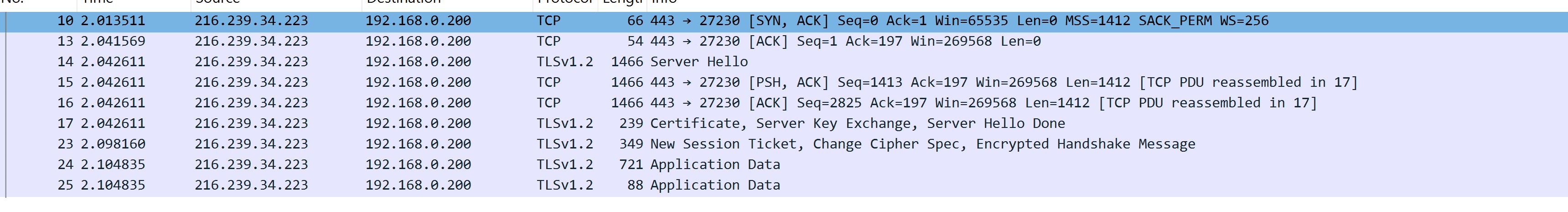

DVSwitch Mobile fails at the WT authentication stage.
Token request returns “Login failed” despite valid credentials.
HTTPS/TLS communication with AllStarLink portal is functional.
Issue is reproducible across multiple accounts (ON4WX, ON4MAX) and devices.
No WT node connection is attempted.
This indicates a backend WT authentication / API regression, likely introduced after recent portal updates.
