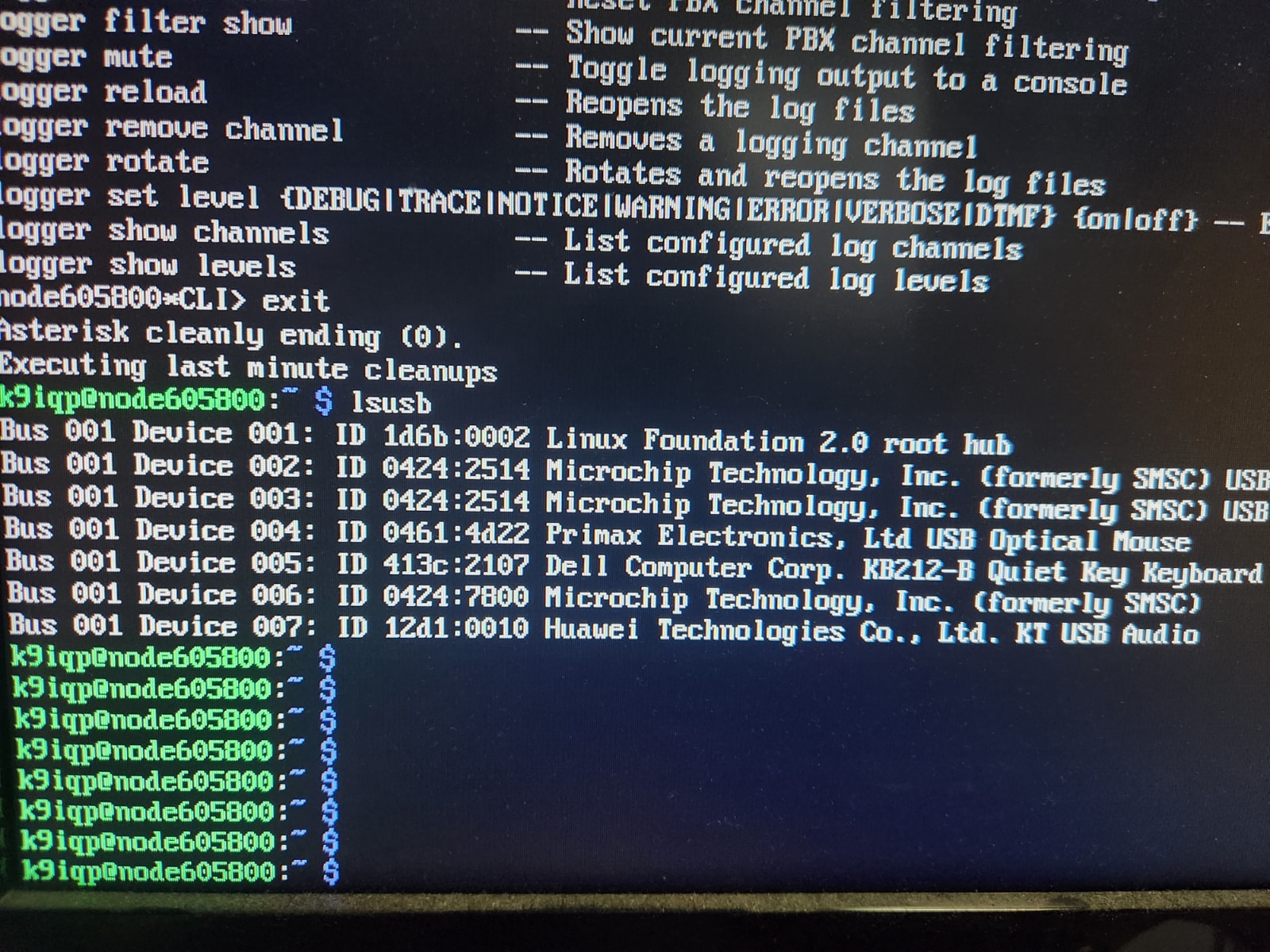

app_rpt does not use ALSA. Only certain types of adapters are currently supported. What does asl-find-sound report and is that properly configured in simpleusb.conf or usbradio.conf?
I wasn’t able to use find-sound. again prolly FNG syntax error[s]
Will Windows control panel/driver info contain that info string?
I'd use lsusb to see what it identifies as. app_rpt only "talks" to a short list of devices...

There KT USB is the fob how would i configure simple usb.conf??
That device is not likely to be compatible with ASL. However you can try it by adding it to /etc/asterisk/res_usbradio.conf:
[general]
usb_devices = 12d1:7388
And then doing the normal setup with asl-menu. However app_rpt only supports C-Media cm10x/cm11x-compatible devices becuase of the GPIO exposure. If this device isn't a CM-compatible chip in the device, it will not work.

I have one that got zorched and will try & crack it open to find the audio chipset the 12d1:0010 number is a device ID and or series number?
