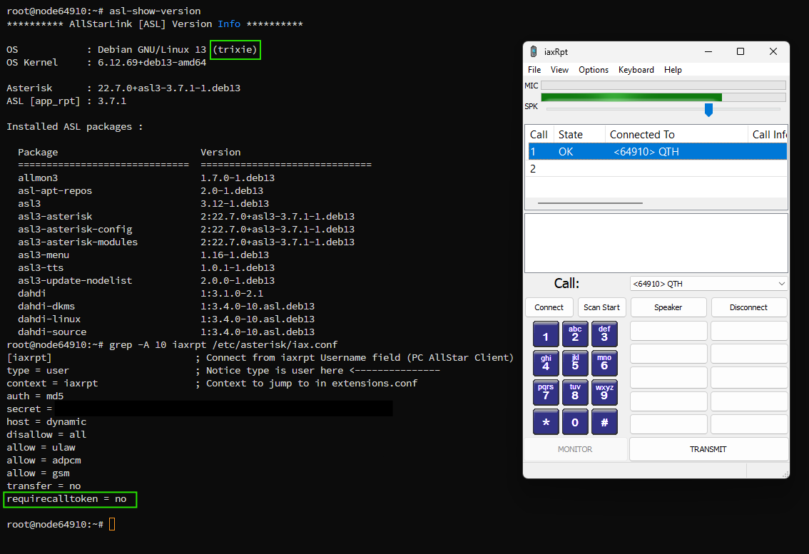

Problem solved. Disregard.
What was the issue? What did you need to change?
Minor change in iaxrpt extension syntax in extensions.conf file that worked in older versions.
