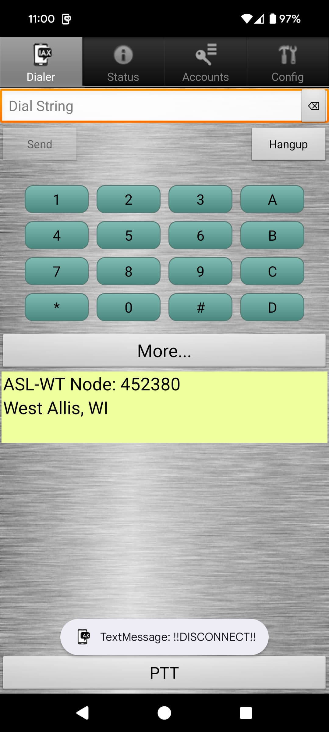

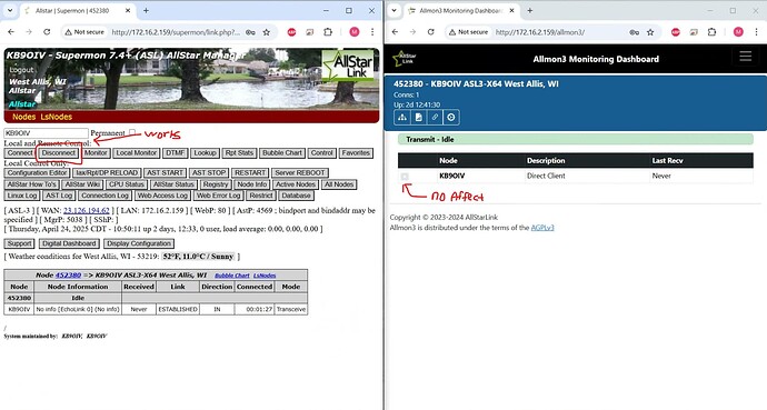

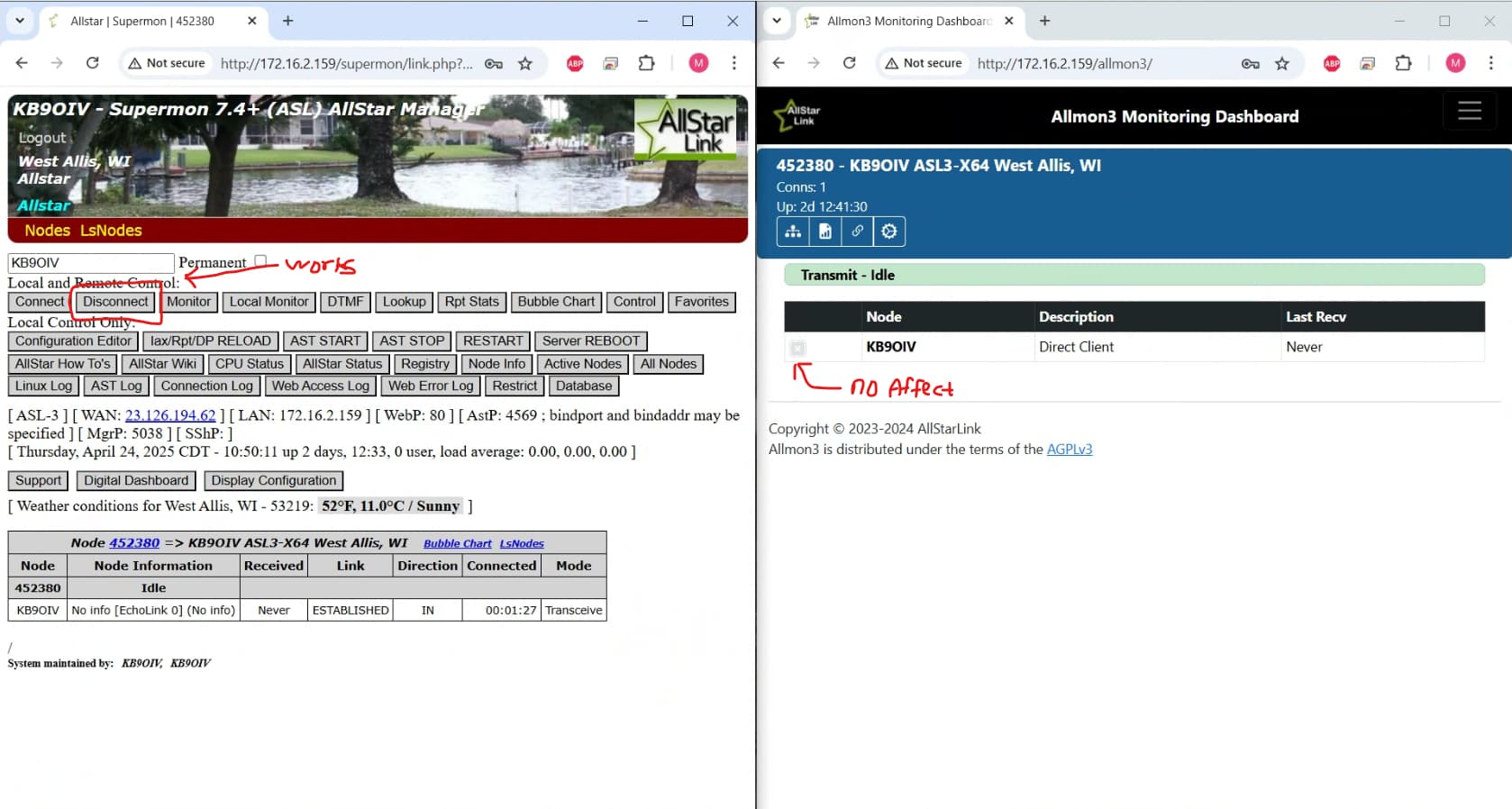

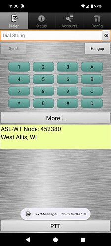

For an example, I have DVSwitch on my android phone. When I connect to my node using the web transceiver mode, my callsign shows in the node number field, and 'Direct Client' for the node info/description.
When I boot my dvswitch client from supermon, client disappears from the node and I get a message on my phone:
"TextMessage: !!DISCONNECT!!"
And DVSWitch on my phone changes such that I have to enter node number and 'connect' again.
I have attached some side by side pics of allmon3 and supermon, and dvswitch:

Probably related, but clicking on the line with a node number that has a callsign such as my example, also doesn't prepopulate for the 'execute linking commands' drop downs.

To add a bit more, clicking on the red 'x' next to a callsign in the 'Node' column does not open the pop up window to do any disconnection actions (including 'prefill'), like it does for line entries for the 'Node' column that are numbers.
