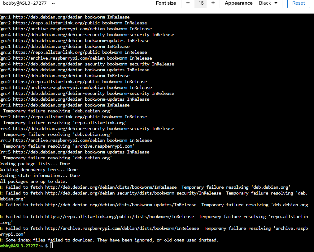

Back to one of the other glitches, can anyone tell me why I get this when I try to do updates?

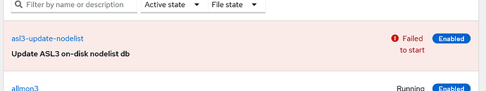

Further, the cockpit update pgm (the 1st time I ran it) said “Updates Failed”
Now it says everything’s up to date. I never got any updates accomplished.

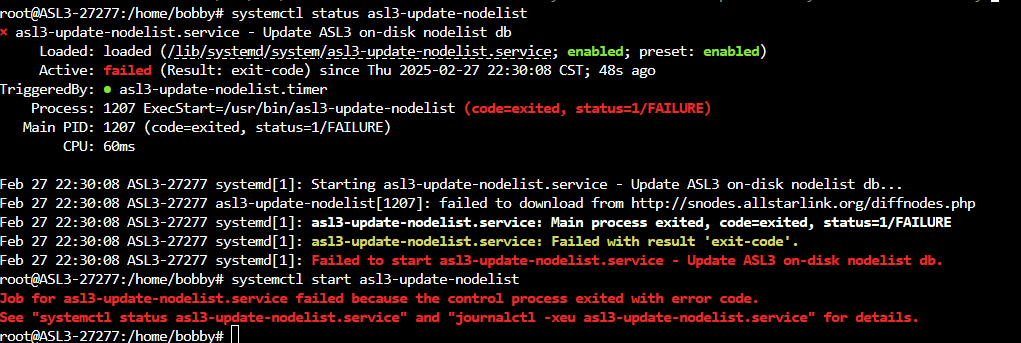

EDIT: Just noticed this:

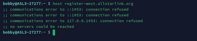

If you do host register-west.allstarlink.org from the Linux shell, what happens?
I also set the register => line in iax.conf but of course that would be useless without DNS I suppose…
Yeah your DNS is messed up. Is this an ASL3 appliance with NetworkManager or a stock Debian system?
You know, I’ve never been a 100% clear on what you guys are referring to when you use the word appliance (I think toaster ovens when I hear the word!); It’s the raspberry pi image. And yes, I used network manager to change the IP.
So go into cockpit on port 9090 and edit the wired or wireless configuration that you changed and in the IPV 4 setting add a DNS server which is likely your Routers IP address. You could also use 9 .9 .9 .9
You rock; that was it. In retrospect, of course when I delete an interface, everything associated with it goes out the window too; When I added the new IP, I didn’t bother to even look down… Thanks again.
