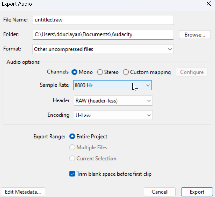

  1. Created & exported file with following settings via Audacity
