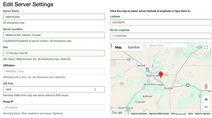

Here is my screenshot
Which is better Internet only or through cloud?
How and where do I change it in the software or do I have reinstall the software
Or do I change it from Public or Private?
What you’re really asking here is very unclear. Nothing about AllStarLink configuration settings can affect your server performance.
I have a 3 second latency. Maybe a different server like Linode may help. Another question does the connection from the raspberry pi go through the internet direct connection to another node without using the cloud? Is the cloud just access the software? I’m on pure fibre 1gb up and down
