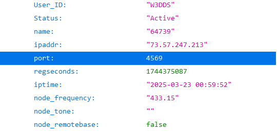

The node shows as registered with a comcast ip address using a port of 4570
But asl stats show you are using port 4569
This will not work.

I am showing both places ports to be 4570

https://stats.allstarlink.org/api/stats/64739
64739=radio@73.57.247.213:4570/64739,73.57.247.213

Changed to 4570 Changed on Allstarlink server and in Asterisk IAX
I just changed them back to 4569 in AS server and asterisk
