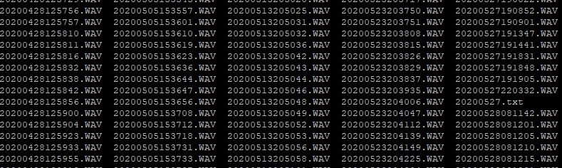

You can log QSO activity on the node by enabling the archivedir=/path/to/some/location argument within specific node(s) within your rpt.conf file. This will log activity to a daily file of node activity in TXT form, but it also dumps WAVs for each node keydown
 which fills up and will eventually kill your SD Card

Disclaimer: This fills up disks fast and will KILL SD CARDS.
  • Don’t use this unless you have a need/want to, and don’t leave it turned on long if you’re running the sequences on a Pi node.
  • If you have a hardware/virtual machine Hub node with a bigger normal disk, try running there and staying “linked” to the Pi node experiencing trouble.

It is possible to make a ram disk to receive those file and then run a bash script every minute the rm .wav from that ram disk. that way you are left with only the txt file that wont take much place.
a cron job is easy to set for such task.

It would be better to add an external USB hard drive or thumb drive and point the archivedir= to that device.

One thing about adding to the USB controler of the RPI could cause some audio skipping to come cause the USB adaptor is already using it continuously.
Both are good points. I wouldn’t be surprised if the mere overhead of logging/writing the WAVs adds some skipping to node audio. I only log QSOs on beefier Hub nodes, so wouldn’t know or notice it.
Any chance there is a way to log TXT without writing the soundfiles at all? The two rpt config arguments (archivedir=/path/ and archiveaudio=x) seem to hint there is way to not have to log both at once? When I last tried to only log TXT with =/path/ on archivedir and =0 on archiveaudio, seems I could only get ASL to both log txt and wav, or nothing at all.

Thank You all for the comments, I will give some of those a try and Using an external USB drive for storage sounds good as I am using a pi 3B+.
Question though, what would happen if the thumb drive filled up? Hmmmm, would the system still crash? :upside_down_face:
James
I personally have not had an issue with audio dropouts recording to usb mounted drive. As for the drive filling up? I’d recommend a large 256Gb drive and a cron job to delete files older than X days
