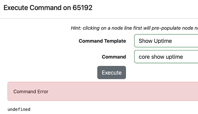

Command error, undefined
Setup: I have ASL running on a Wyse 3040 (Debian) and a UCI120 node. I can connect to other nodes using DTMF commands, and by using the asterisk command line. Now the problem with Allmon3...
I can log into allmon3 with no problem. Anything I try to do as far as linking, showing node status, etc. is met with the error "undefined."

Your /etc/asterisk/manager.conf should have a stanza with :
[admin]
secret = <ami-password>
The "pass=" in the allmon3.ini file should match this "secret=".
Yes, you're correct. I was looking at a different config file.
The passwords do match.
So it must be another cause. I did try another browser and got the same error.
I changed the the host information from my lan IP address to 127.0.0.1 and restarted the Allmon service. All working now.
