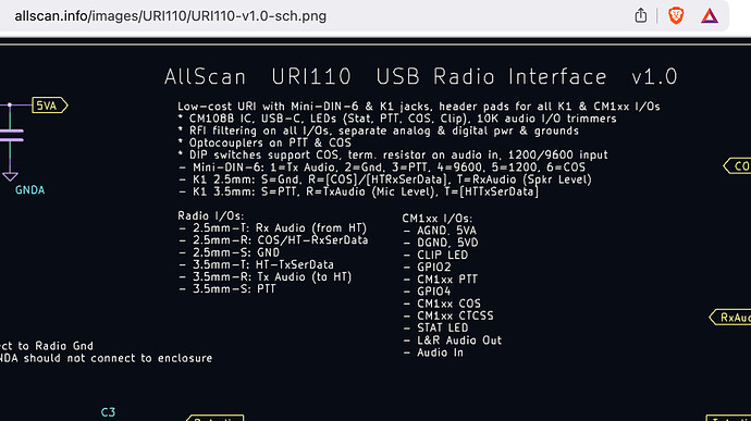

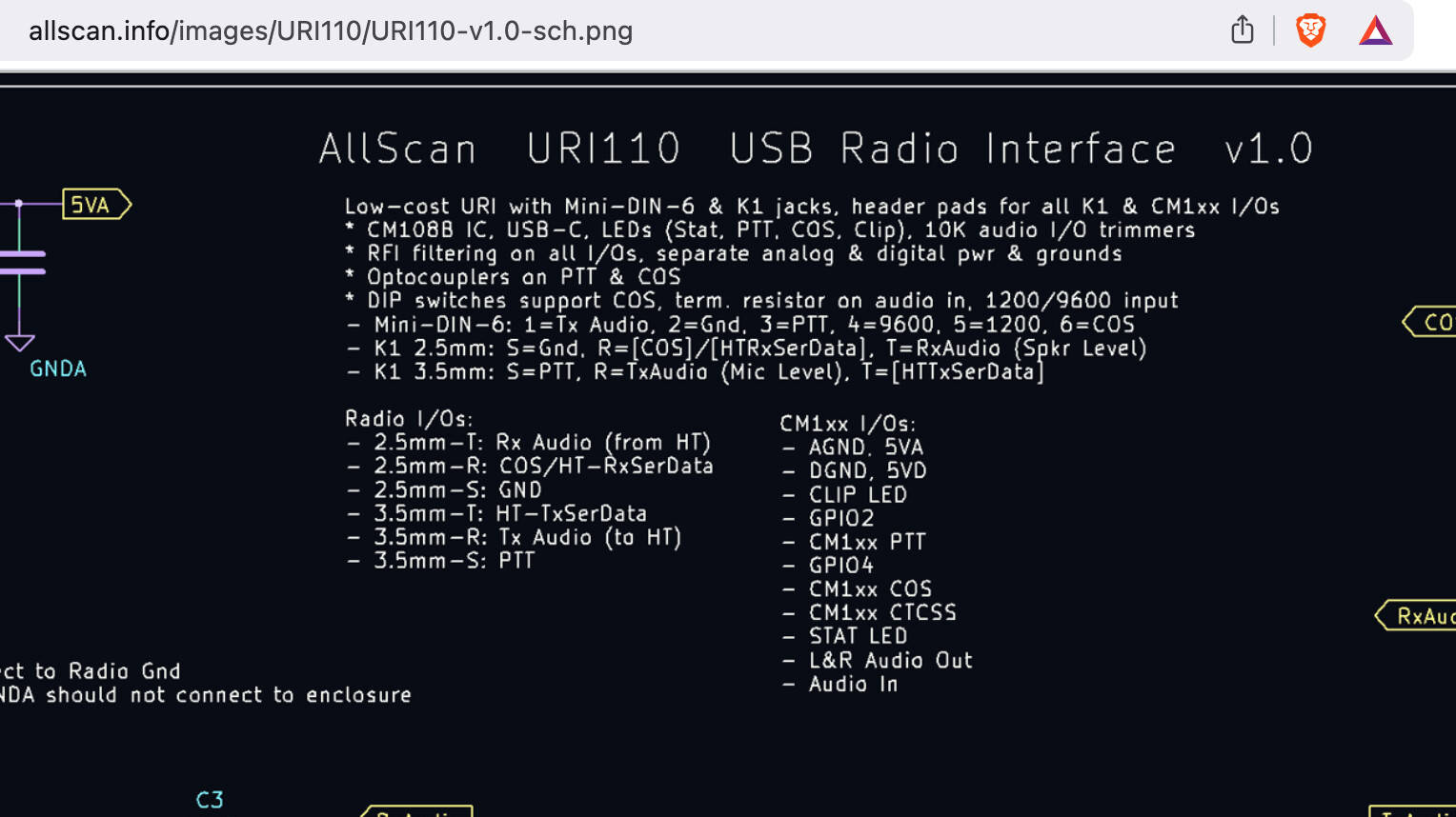

I am not sure if this will help as I have soldered wires directly to my baofeng 888 and baofeng uv82 handsets however you can find info from allscan.info schematics for the URI. Allscan.info has lots of useful information and for the best experience, you can purchase one from there directly as well.
