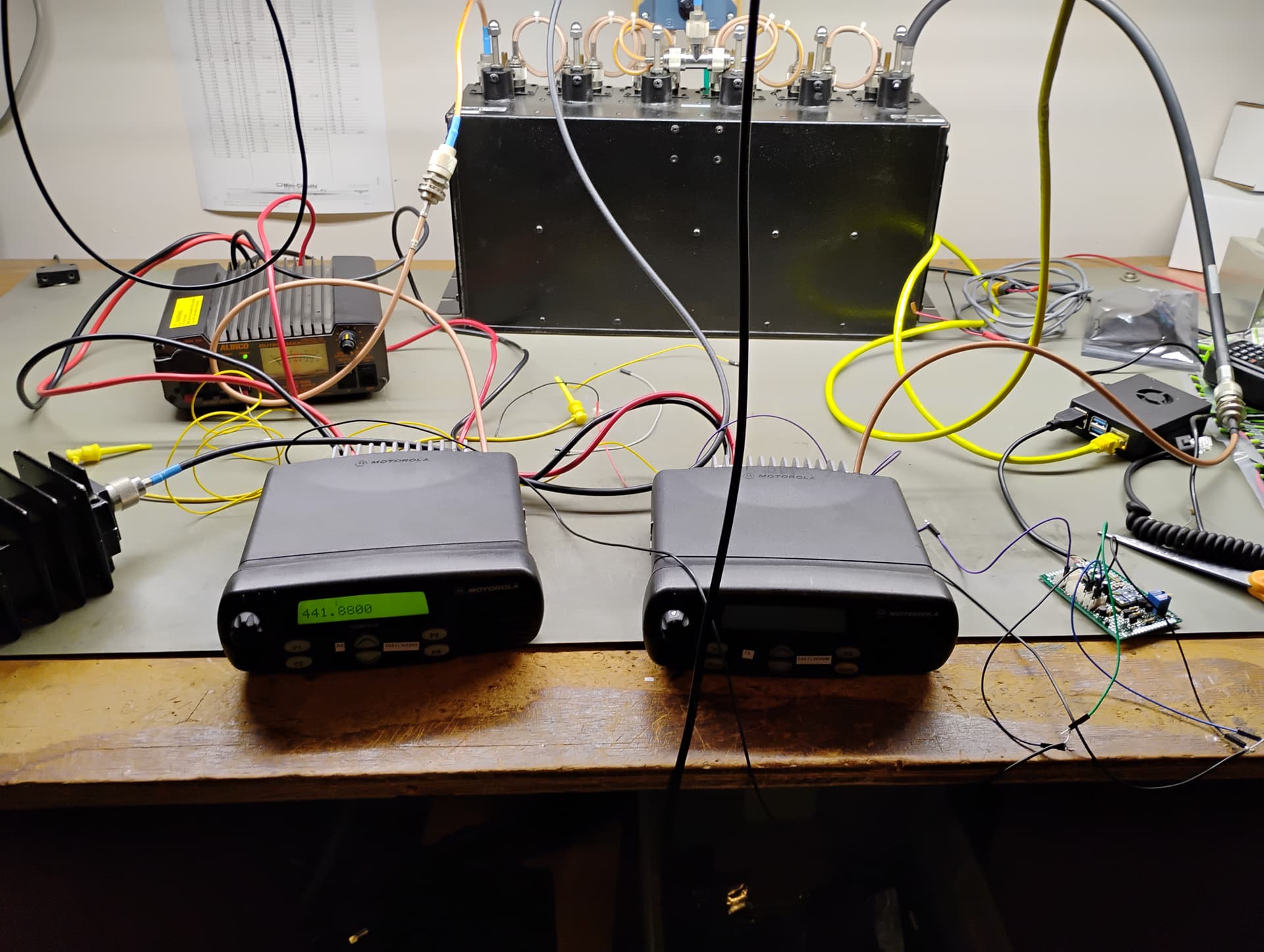

I'm using 2 CDM1250s in my setup.
The RIM_Maxtrac will plug directly into the rear of the Motorola Maxtrac/GM300/CDM series radio. (with the radios with 20 pin connectors, plug it into the center 16 pins)
