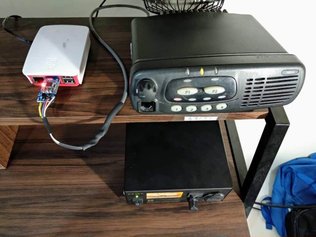

Hello, I have a Motorola DM-3601. Is there a way to interface it with a CM108?
All MotoTRBO radios should be compatible. If memory serves, that’s the equivelant of the NA market XPR4550.
I was looking for a CM108 mod that works well with my Motorola DM3601 radio. Can you recommend one?
Do you think this mod for the Motorola GM340 would also work for my radio?
Let me know.
The fob should work on any radio; you just have to match it to the same signals on the radio. Find PTT, COS, TX audio, RX audio and ground (might involve programming accessory port pins in the CPS).
As someone mentioned that is the same radio as the North American XPR series. I build a cable to go from our General Purpose RIM_Lite to the XPR series. Both the interface and cable can be found on this product page:
I tried searching the page you gave me, but I couldn't find the right one for my radio (Motorola DM-3601). Please note that my radio has a 26-pin connector.
Already said in a previous post: XPR4550. Applies to ALL XPR radios. They're identical radios with the exception of the sticker on the front and a couple of flipped bits in the codeplug for the region.
As KK6RQ mentioned, your radio is equivalent to the USA XPR series. You would need to order both a cable to go from the XPR series to my RIM_Lite, and also the RIM_Lite itself. Both items can be ordered from the page I provided. Feel free to e-mail me direct if you’d like. [My callsign]@repeater-builder.com
