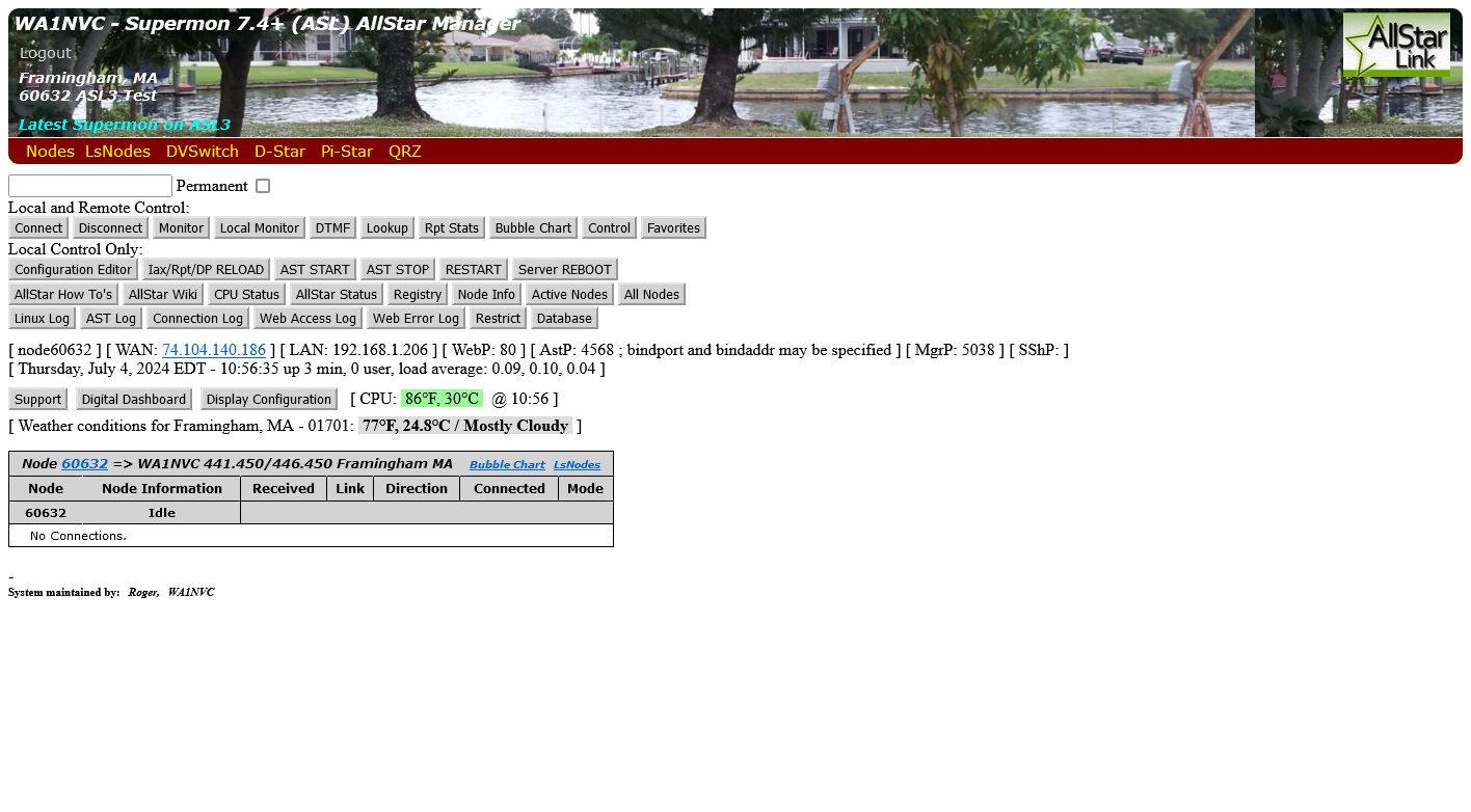

Using Allmon3 “Show Node Status”, Allmon hangs with this flashing dot, and the HB stops.
So I got ambitious and installed the latest Supermon 7.4+
If I click on “Rpt Stats”, Supermon does not hang but the HB stops.
So Allmon or Supermon Node Status(Allstarlink site) cause ASL to die.
Any thoughts? Apache problem?

After all the problems I encountered trying to make ASL3 work, I’m posting the solution so others do not have the same bad experience.
I was discouraged and set the project aside for a week.
I used my second set of identical hardware and it worked perfectly. I even installed Supermon 7.4+. The whole process took less than an hour. Later I did the first set of hardware again and it also worked perfectly.
The solution is after the first RPi boot, WAIT, WAIT, WAIT!!!
The PTT light will go on and off, the COM light will come on, the HB light will start flashing, you can bring up the Launch Pad web page and log in to the Web Admin Portal. DON’T!!!
WAIT, WAIT, WAIT about 5 minutes until all the disc activity has stopped.
This was my solution found by accident.
Even if you can ping the node, view the Launch Pad, log into the Web Admin Portal, DON’T!!! For some reason this was repeatedly corrupting my installs.
I think this needs to be emphasized in the User Guide.
