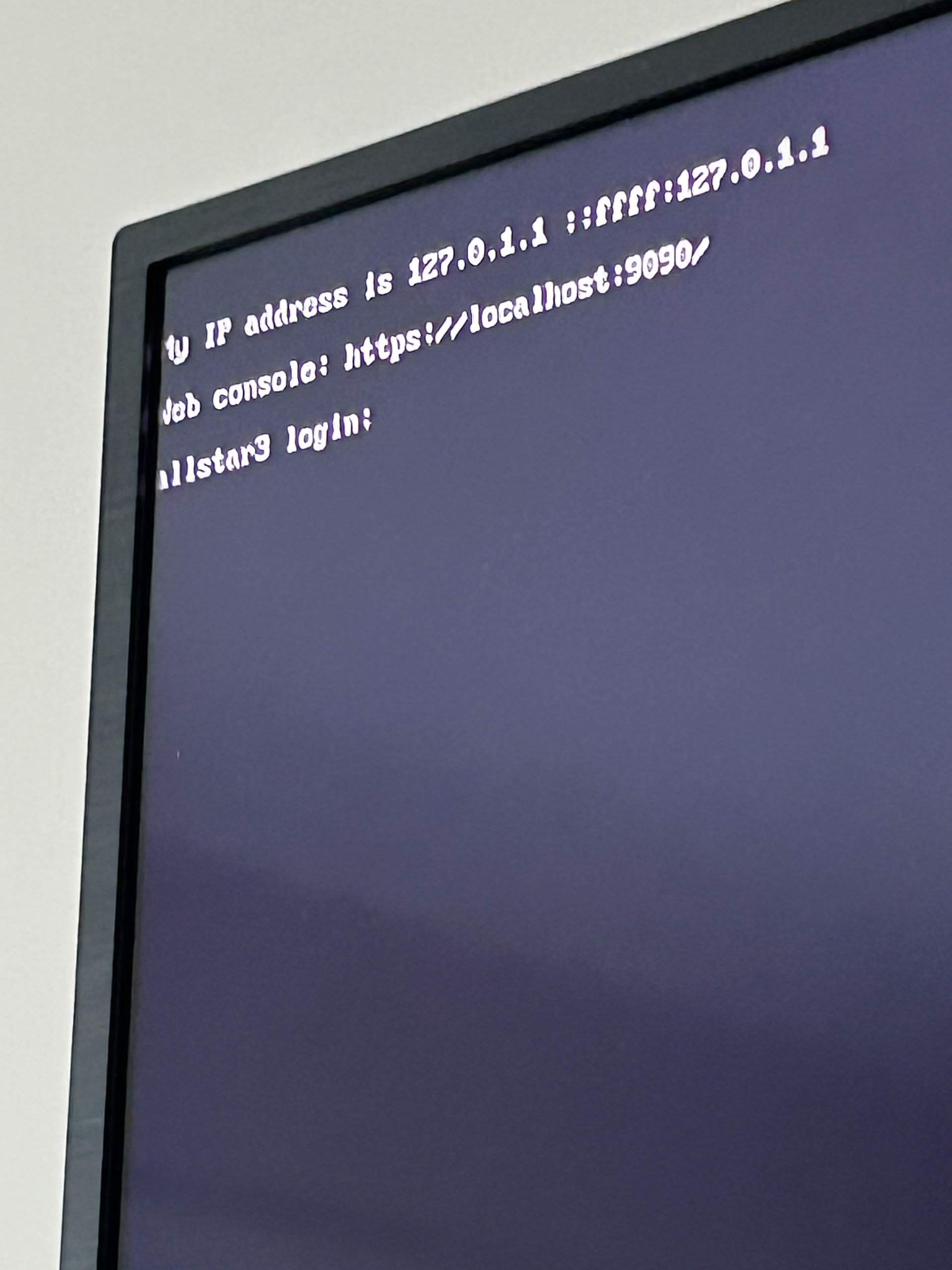

I’m stuck at this screen and I do not own a Linux system. Any suggestions?
Your node IS a Linux system; that's the Linux login terminal.
Sorry as I said I’m not up to scratch with these things. So does this mean the node will need to be re-imaged? As mentioned it was working and showing up on all start, but I can’t get it on the WiFi at all.
I wouldn't necessarily say that until you log in and run some commands. Why don't you log in and run the command Jason suggested, and see if you can add a Wi-Fi network...

I also,can’t log in as it’s not connecting to my wifi
I should add when you're typing the username to login, you would see it but you wouldn't see your password on the screen as you type it. A direct connection with a keyboard and monitor doesn't require the Wi-Fi to be working. I mean, unless you've got a wireless keyboard or something like that, which of course wouldn't work.
No it’s straight usb cable keyboard. So would the cursor move as I type as it just flashes

At the login: prompt you should see any letters that you type. At the password: prompt, you will not see anything.
Oh ok well I don’t see anything when typing but when I flash the node up a light on the keyboard blinks. Yes system preconfigured allstar node on a Raspberry PI 3A+. All passwords for allstar dashboard, allmon ,node and my WiFi were provided and printed and sent with the node WiFi details match. I’ve been in contact and he states node was working, yes I’ve seen it live and it was showing online at the time. He suggested an error my end but I can’t see what
Most keyboards should "just work".
If you are seeing the login: prompt and type "abc" you should see "abc" (and the backspace should work too). After entering your login username you would press the Enter/Return key and be prompted for the "password:". If you don't get any response from your keyboard actions I would try another keyboard.
Also, you are plugging the keyboard's USB cable directly into the Raspberry Pi, correct?
A Raspberry Pi 3A+?
For logging into at the [Debian Linux] login: prompt you most likely would want to use the "allstar dashboard" credentials (not the "allmon" info, not the "node" info, and not the "WiFi" info).
Please know that both the login and password strings are case sensitive (lower/upper case matters). Also, watch out for the difference between the letter "O", and the digit "0".
yeah rasp PI 3+. Brand new keyboard and nope abc doesn’t work either so I could always try another I guess. But the lights did flash on boot up
No use with keyboard which is strange as the lights flash on boot. Would my node settings on allstar effect anything?
