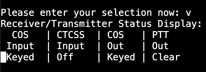

Attempting to connect a RIM-Lite with Raspberry Pi 4+ to a Retevis RT-97L repeater. I’ve followed the settings for simpleusb on the Repeater-Builder website but cannot get the audio to go through the RIM-Lite.
I have tried it setup as both Half duplex with telemetry (1) and Full duplex with telemetry (2). Neither sends the audio through the RIM-Lite according to the Asterisk CLI.
With settings:
Carrier from = usbinvert
CTCSS From = no
The view COS, CTCC, PTT status gives this when keyed up:
After releasing the PTT on the radio PTT on the view status briefly switched to keyed and I get the unkey tone.
