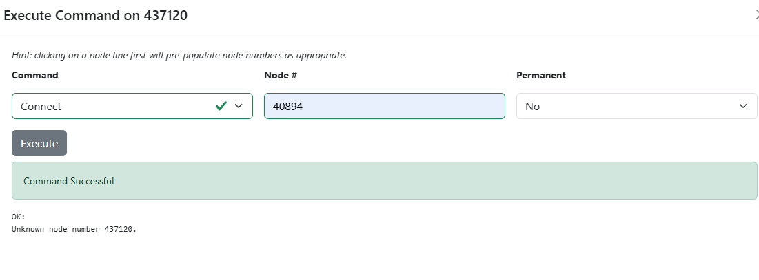

I am in a bit of a bind and quite confused and hope to get a solution here, I recently installed ASL3 on a laptop running Debian 12, and I configured it to run as a radioless hub, I also configured iax.conf and extensions.conf so I will be able to use DVSwitch mobile app to connect to it. on checking the website, it shows up as registered. when I dial in with DVSwitch using IAX2 it rings and announces that it is connected to the node but then disconnects immediately, when I try connecting to another node using allmon3 I get this message that states “unknown node number 473120” When I run asterisks -rvvv I get this output when I try dialling in.

Are you using asl-menu to setup the node? That error means your Asterisk/app_rpt configuration isn’t right and your node 437120 isn’t working. Restart asterisk and look at the output of /var/log/asterisk/messages.log for any errors about app_rpt not starting for that node.
