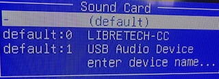

alsamixer -- I have designated "Default 1" "USB Audio Device" as my card (other option was LIBRETECH-CC "Default 0"). Speaker set @ 32 and and MIC capture @ 60; MIC is muted.
I am somewhat suspicious of what alsamixer is calling the two sound cards Default 0 (LIBRETECH-CC) and Default 1 (USB Audio Device) but am unclear whether it has any bearing on my problem.

I've made these system-wide changes using to ALSA conf file to ensure Card 1 ("USB Audio Device") was the default sound card then rebooted. No changes, i.e., no COS light, no audio.
ASL3 does not use ALSA so setting that will do nothing. What does the command asl-find-sound report about compatible audio devices?
