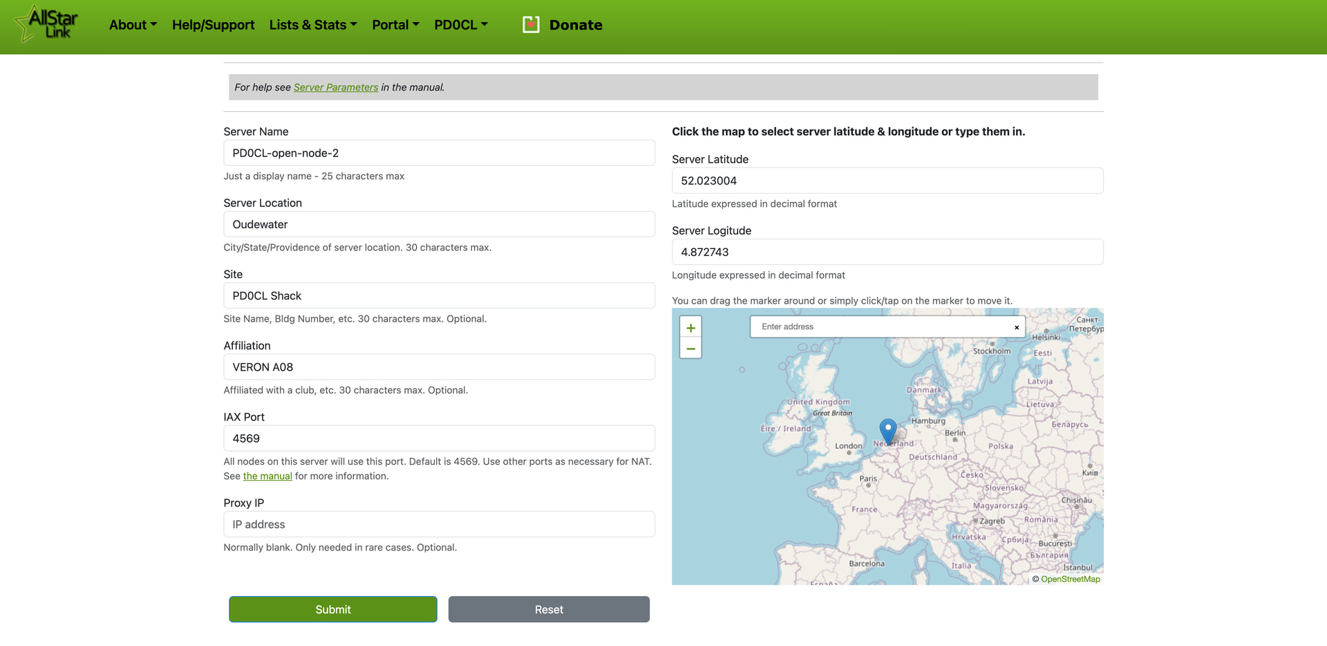

The stats & bubble map gets its info from your server and node definitions at allstarlink.org.
Tinker with those one at a time (and wait a few minutes for the change to take) and you'll figure out what goes where. It took me a few tries.

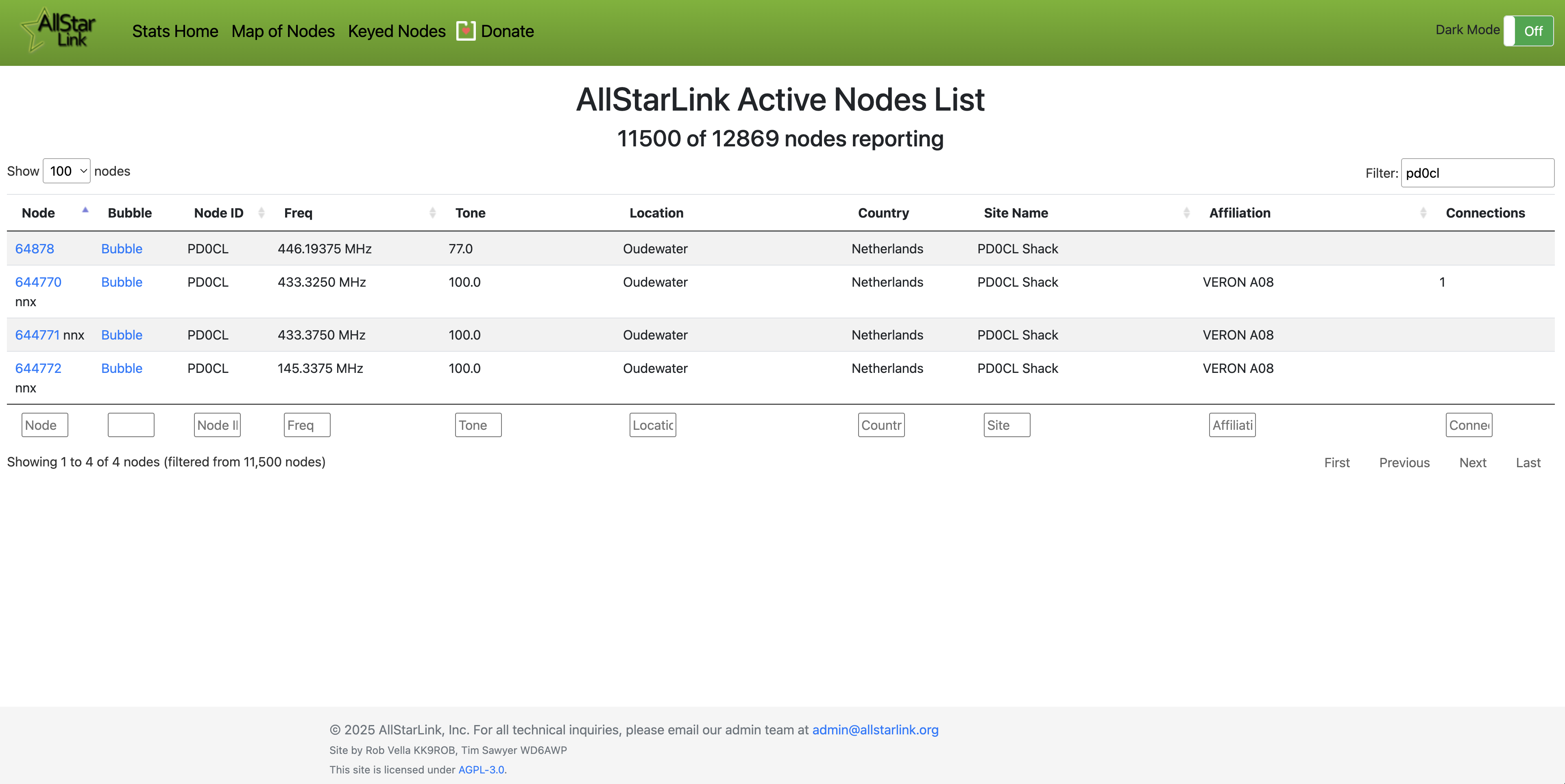

  • Network map: 144.775 MHz

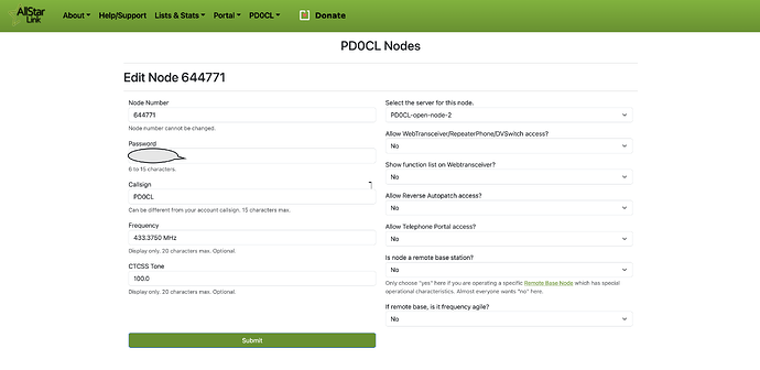

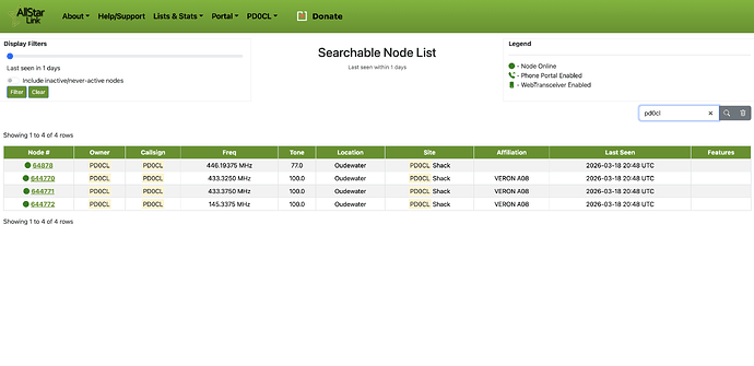

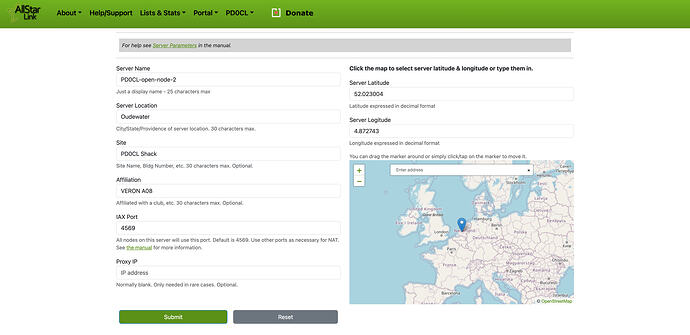

And to prove that i’ve done it:

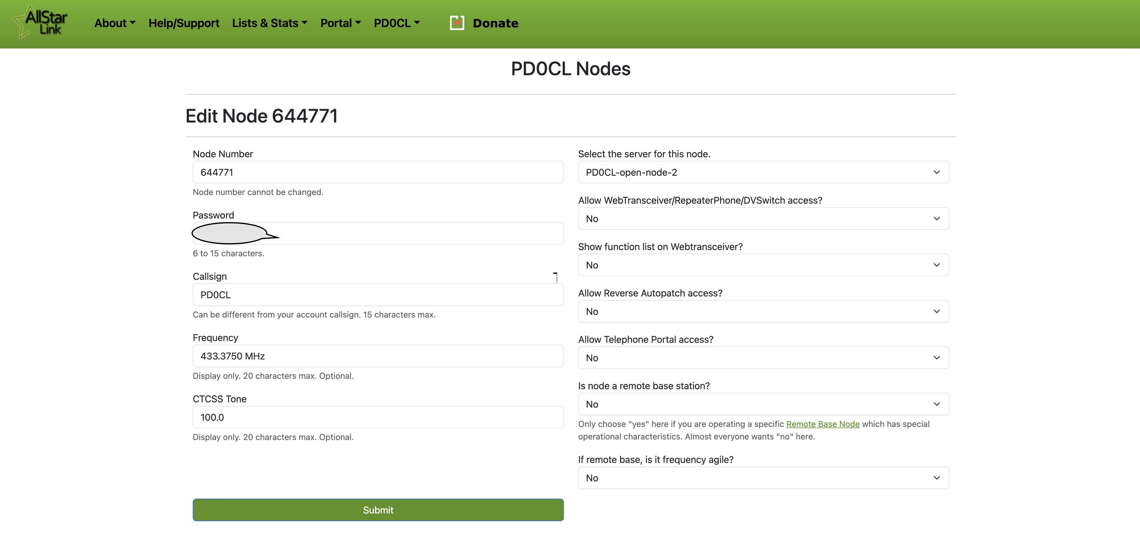

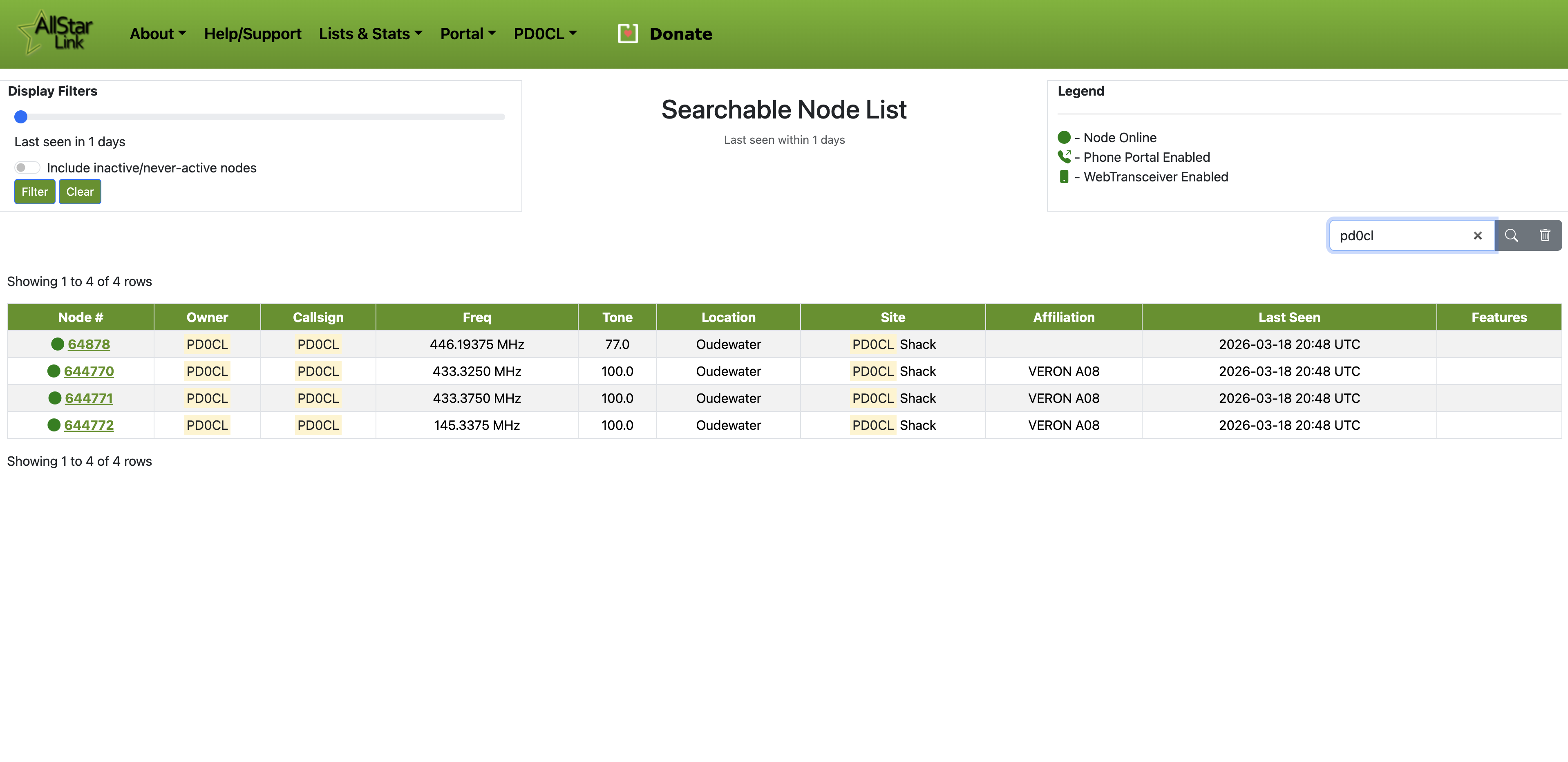

And to prove that i’ts there:
by any chance did you happen to resubmit the frequency information on the Portal just now?
Hi!
Yes. I did re-submit the frequency in the portal earlier while troubleshooting this issue. But I did this many times….

I see the bubble map shows 644771 on 2m, incorrectly. Stats look correct for your nodes. Is there any reference to the 144.775 frequency in your asterisk configs, manager.conf or something? That could be getting sent out with your stats.

The stats system has some caching bugs. This is one of them. However it’s a low priority thing because it’s not essential to ASL operations. I”ll try look into it this weekend.
your node was transmitting static continuously. yes, i managed to connect.
I believe I've fixed the "cache busting" issue with the Portal. When you make changes there, they should now replicate timely to the stats info and the bubble graphs
