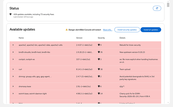

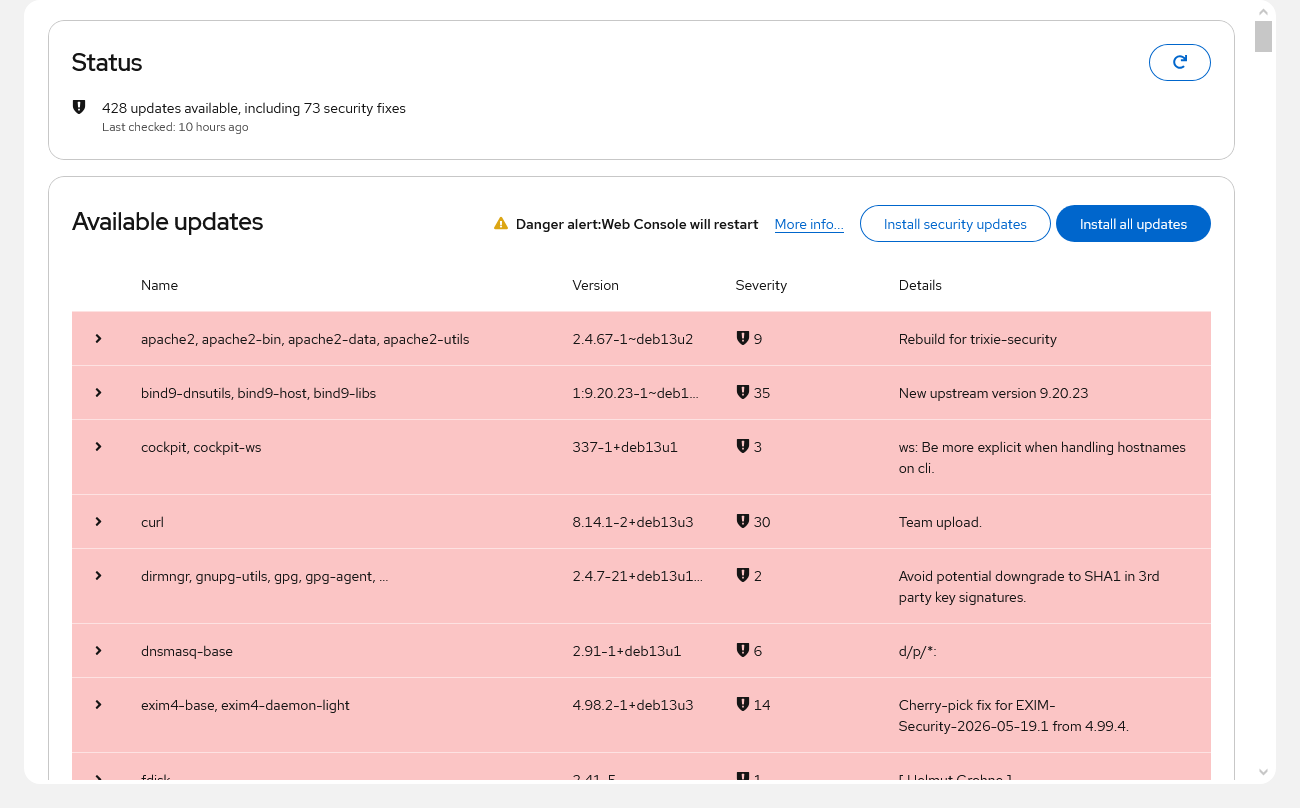

After a reboot, in the Cockpit I selected "Software Updates"
It shows 428 updates available

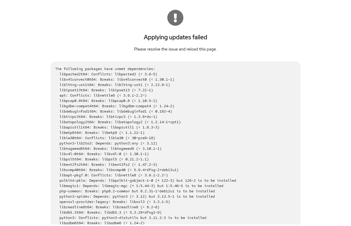

Clicking install yields:
" Applying updates failed" with two pages of unmet dependencies
Time for a re-image and restore of online backup?

Can you provide the logs? There's likely a simple solution if you can provide the output.
I was only able to capture what is visible. For some reason I could not get all of it.
