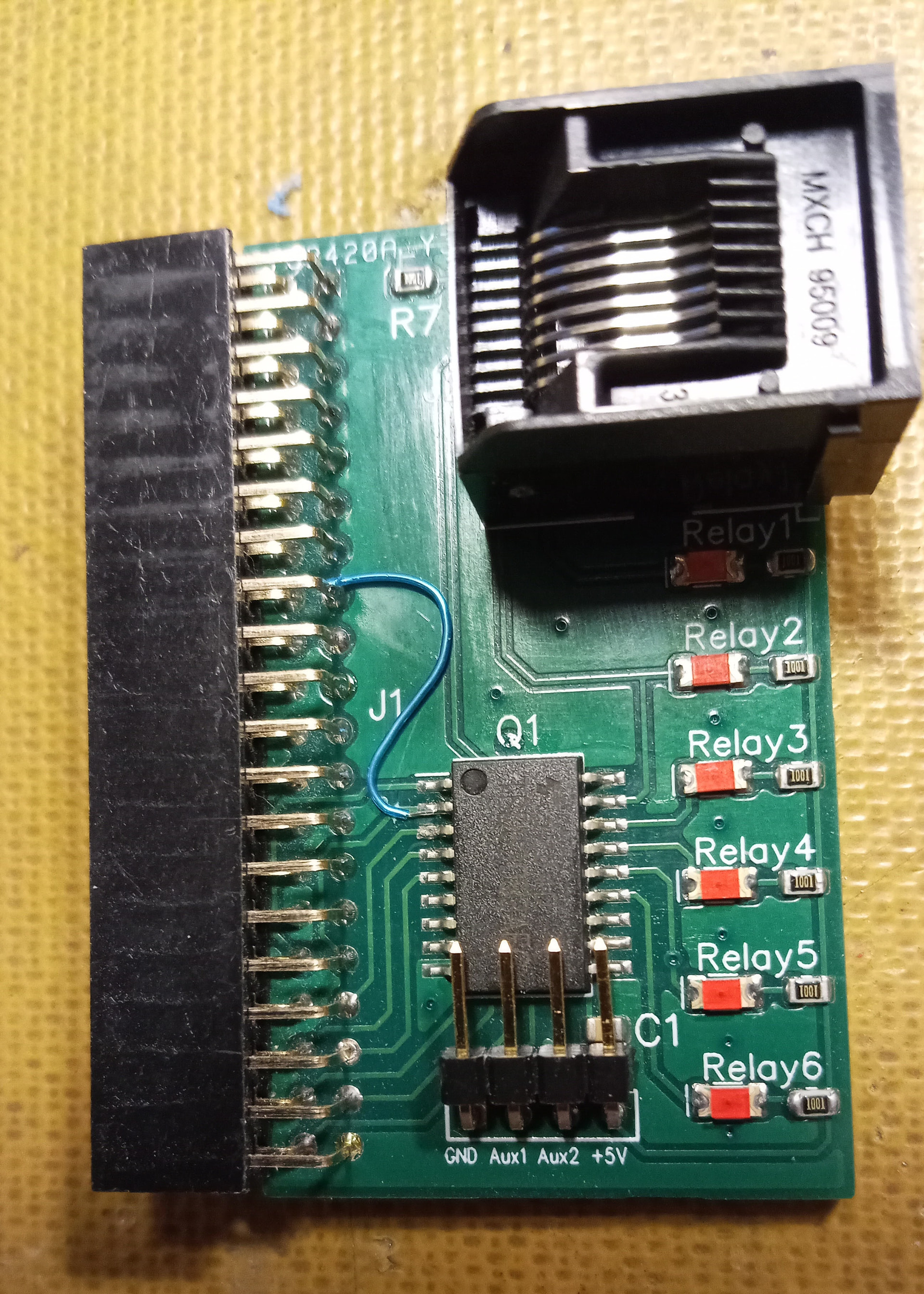

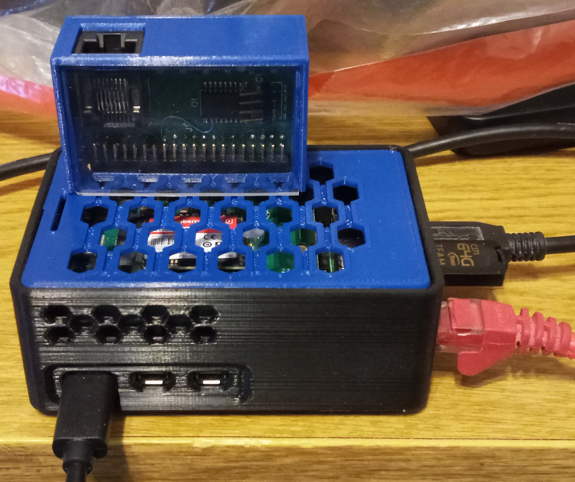

I have not completed the converison and testing yet with ASL3, but I at least wanted to share my method. I also built a hardware interface to talk to the radio. We also use this interface on another node for controlling relays to power off devices at the remote site. We built the first board for a Pi400 and that's why it's oriented that way. You need some way to isolate the Pi GPIO pins from higher voltages so you don't kill them. I would imagine any off the shelf relay driver might work. One caution, some pins are pulled high on boot up and others are low. That's why the wire mod on my origional PC board. The picture is a Pi5 we have just deployed and that is working for our power control circuits. Hope this helps. I am going to get back to that very project.
