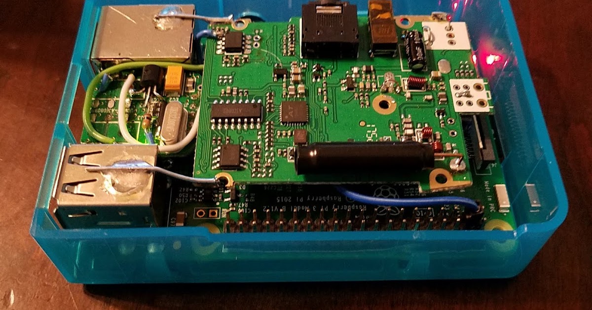

I had the same problem as the OP and after making a few Bryans that worked then started to have problems with them because the newer versions of the 888 had moved certain things around. I gave up on the idea of the baofeng 888 and found the AIOC that lets you use whatever radio with a Kenwood connector and depending on where you get the AIOC from there might be no soldering at all.
The last portable node I made with an 888 was taken out of the case with the AIOC and it made it small-is because I kept the aluminum part to dissipate the heat, if not it would have been just a bit bigger than a Raspberry Pi case.
