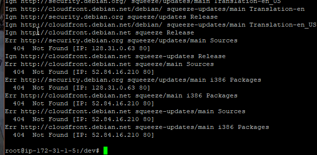

Well, I redid my AWS to be debian x86.
Now, i'm getting the attached trying to run this:
wget https://github.com/AllStarLink/Asterisk/raw/develop/allstar/repository/install-repository
from the FAQ.
any ideas?

Looks like your distribution/wget is running an old version of OpenSSL that can’t speak the protocols supported by Github.
Tom KD7LXL

yeah i think your right. do you happen to know how to do an OS update
or update the SSL? I think this image is from 2014.

You said you were using Debian, so this method should apply:
https://www.debian.org/doc/manuals/debian-faq/ch-uptodate.en.html
Tom KD7LXL

it doesn't appear everything updates?

We’re getting outside of the scope of this mailing list now, but make sure your EC2 instance has a public IP address, your VPC has an internet gateway, and your routing table has a default route to that internet gateway. For updates, you could also get away with a NAT gateway, and default route in your table to that NAT gateway, but for Allstar you’ll want the public IP address.
Tom KD7LXL
