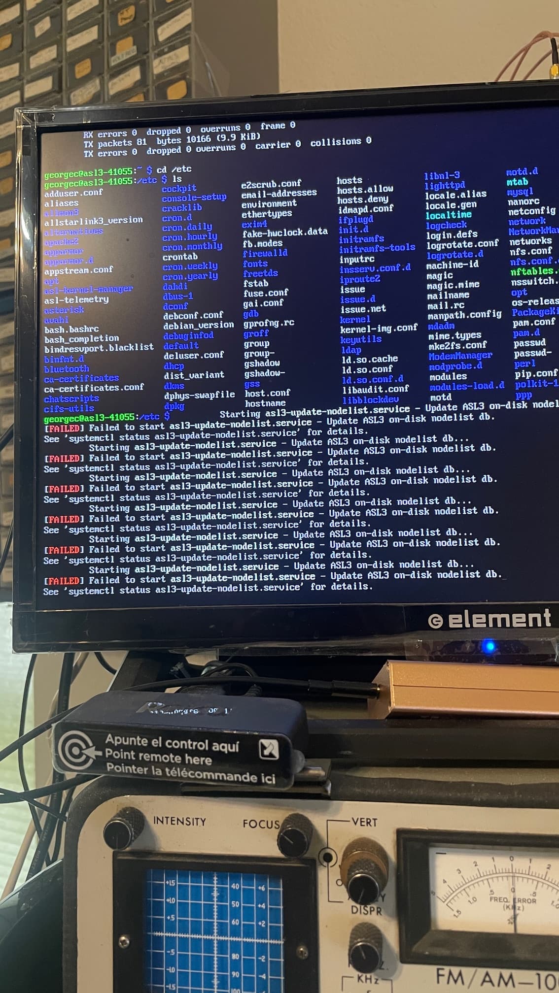

It does work fine with a wired net connection. And while on that tried an update but get errors there:
Service logs
View all logs
July 8, 2025
2:45 AM
Failed to start asl3-update-nodelist.service - Update ASL3 on-disk nodelist db.
systemd
2:45 AM
asl3-update-nodelist.service: Failed with result 'exit-code'.
systemd
2:45 AM
asl3-update-nodelist.service: Main process exited, code=exited, status=1/FAILURE
systemd
2:45 AM
failed to download from http://snodes.allstarlink.org/diffnodes.php
2:45 AM
/usr/bin/asl3-update-nodelist: line 43: 18878 Segmentation fault wget --user-agent="$USERAGENT" -q -O $EXTNODESTMP "${NODE_URL}${1}"
2:45 AM
Starting asl3-update-nodelist.service - Update ASL3 on-disk nodelist db...
systemd
2:44 AM
systemd
2:44 AM
systemd
2:44 AM
systemd
2:44 AM
how do I fix these issues?

There's not much to the asl3-update-nodelist.service. It simply executes the /usr/bin/asl3-update-nodelist script. The two issues I've seen relate to networking (DNS errors, internet connectivity) and file permissions (the files in /var/lib/asterisk should all be owned by "asterisk"). If you are still having issues it would be good to exec :
sudo -u asterisk bash -x /usr/bin/asl3-update-nodelist

This is NOT an issue with ASL3. The wget utility is a standard tool and a segmentation fault means the application itself is crashing when executed. That almost assuredly means a corrupted installation because wget is a common tool used all over.
