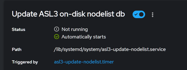

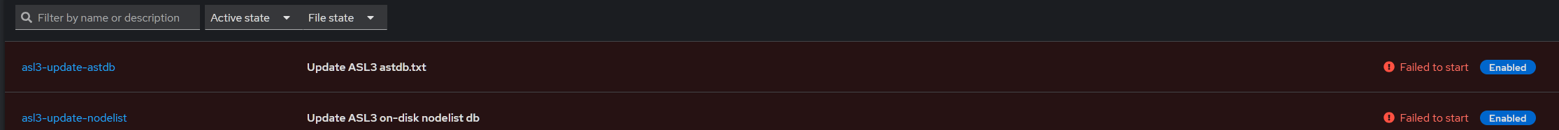

Is there something going on with AllStar3 as far as service goes? Today out of the blue none of my 4 nodes is working and my nodes list are not updating:
Trying to start the services manually will fail.

Cloudflare is having issues today affecting most of the internet.
That must be it…thanks, I was able to manually update the node list but the service won’t run automatically, probable is not getting response from the servers.
ASL uses Cloudflare to deliver the text database for app_rpt, Allmon, and all the package downloads. It should be noted that DNS lookup and node registration was not impacted. One more reason not to use file-based downloads for nodes.
I had the same issue and my update service kept stopping, and I didn’t figure it out right away, but I started to suspect when I was reading about that outage it did eventually restart on its own though as services from Cloudflare were restored.
