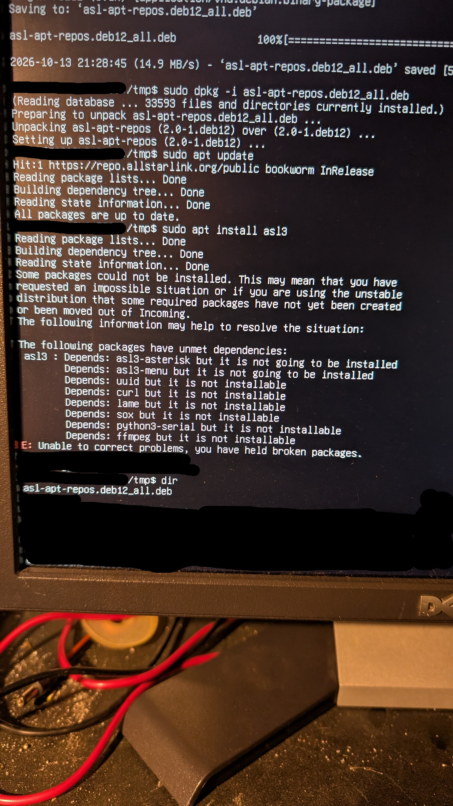

Debian12 is installed. Trying to install ASL3. Repository has been copied to the TMP folder. I keep getting dependency fails and some packages not being found. Below is a screen cap of the fail. Any suggestion is appreciated.

I just completed a clean bookworm install in a VM using debian 12.15.0. I added the asl repo package, updated then apt install asl3 without a problem. Could you please post the full output of apt update.
I noticed you had a single hit with apt update .... which is not correct you should have seen something closer to
Hit:1 http://deb.debian.org/debian bookworm InRelease
Hit:2 http://security.debian.org/debian-security bookworm-security InRelease
Hit:3 http://deb.debian.org/debian bookworm-updates InRelease
Hit:4 https://repo.allstarlink.org/public bookworm InRelease
Reading package lists... Done
@KA1LM, did you install, or is the installed OS, the 32-bit or 64-bit version? You need the 64-bit OS.
I will check tonight, but believe it was 64-bit.
"Full output"? More than shown in the middle of the pix "SUDO APT UPDATE"?
Full output would be what I showed you there, most of them packages comes from debian repo not the asl repo. You only show the single repo in your screenshot which would explain why you are not finding the deps correctly.

I reloaded Debian 12.15 from Netinstall and ALL WORKS! ASL3 loaded instantly and configurations of modules is normal. The non-Netinstall I tried must not have loaded all needed files. I will do Netinstall from now on! Thanks for the support!
