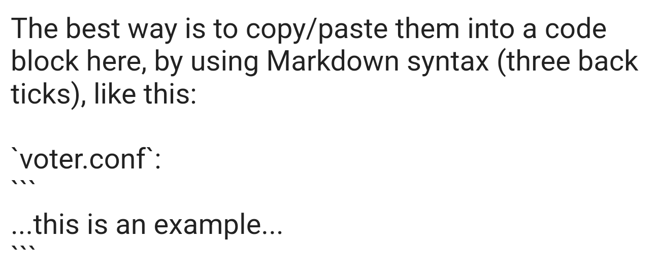

The best way is to copy/paste them into a code block here, by using Markdown syntax (three back ticks), like this:
voter.conf:
...this is an example...
