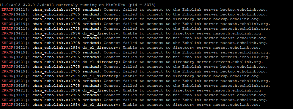

I was able to configure echolink to my ASL3 node before. I disabled it for a while then I decided to enable it again. Now I am stuck on this problem. I don’t know why and I tried some solutions but still no luck. Maybe someone can help me out.
Asterisk CLI

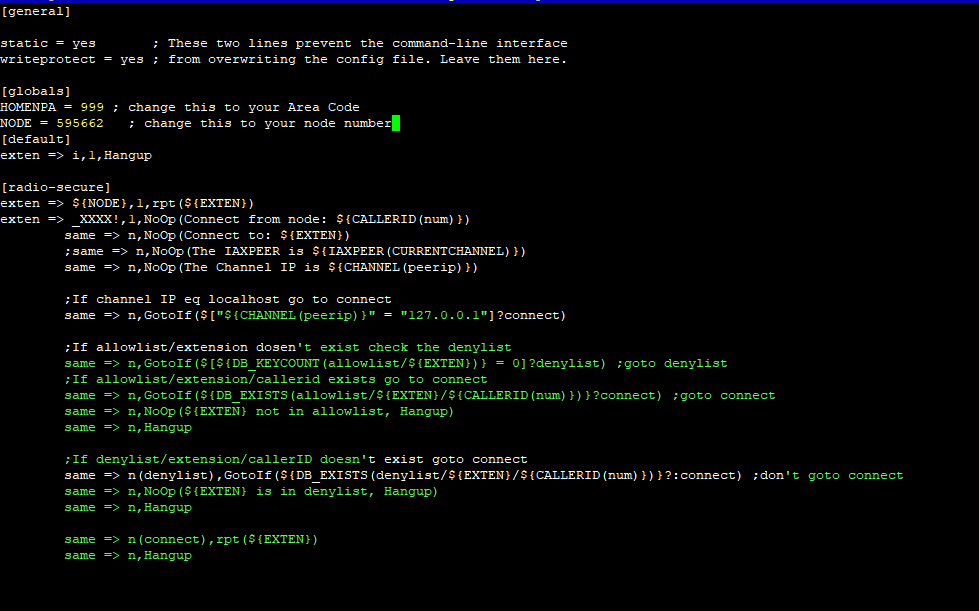

Extrension.conf

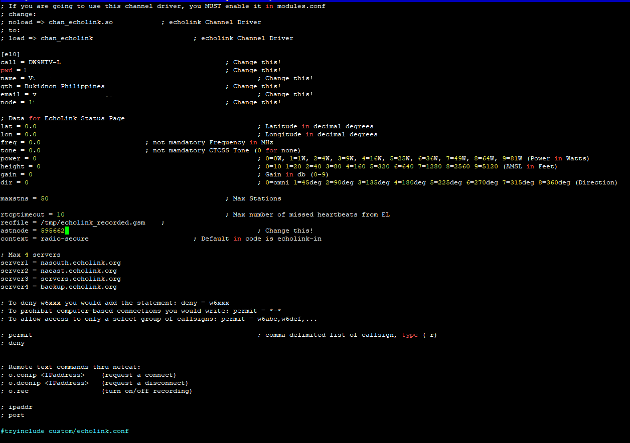

Echolink.conf

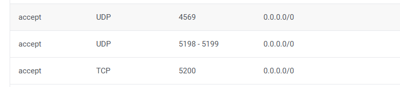

Firewall Config
In Your firewall port forward it looks like you forwarded to 0.0.0.0 and you should have forward it to your node IP address, I don’t see your node ip address but I am sure you must know what that is.

0.0.0.0/0 means anywhere.

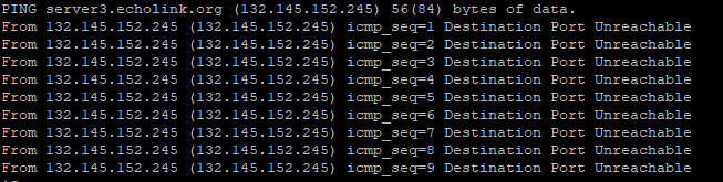

On the server, what does ping nasouth.echolink.org show? Does it resolve the name?
It says destination port unreachable.

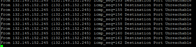

I also tried to remove the firewall and ping the server, unlucky, same result.
Is this a cloud server provider problem or the EL servers are blocking my VPS?
That error is an ICMP Type 3 Code 3 issue. Is your local host’s IP 132.145.152.245? That means that your system is unable to route the packet which means you have a networking problem either on your host or with your hosting provider.

132.145.152.245 is the IP address of the domain name nasouth.echolink.org

I have tried to contact the technical team of the VPS service provider and they said, that my IP address may have been blocked by echolink server. Were there any issues like this before?
Is there a way that I can communicate with EL team so that I can ask them to unblock my IP?
For some reason, my server was sending empty packets along time ago as per information from EL team thats why my IP was blocked. They already removed it from the block list and now, everything is working fine.
