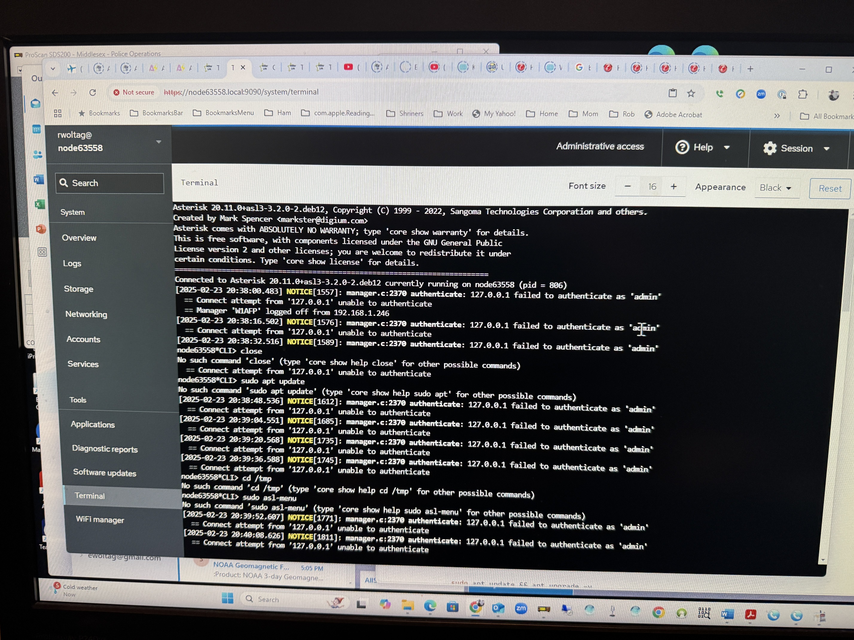

Hello, I appear to be getting the attached errors when I go into ASL Terminal, Enter the Asterisk CLI. Any idea how I can fix this?
Everything does seem to be working aside from the attached errors.
Thanks Rob W1AFP
That just means that something is trying to login to the Asterisk Manager Interface (AMI) as the user “admin” with an incorrect password.
Did you try to set up Allmon, Allscan, Supermon, or something else? Make sure you’ve got your AMI password typed correctly in the configuration for those.
The AMI password can be changed through asl-menu
Thank you, yes, I did attempt to setup Supermon about 2 weeks ago. I think that may be causing it. I will check AMI password in asl-menu. I just dont recall where the Supermon admin/pw is and where I have to match it up. thanks! Rob
