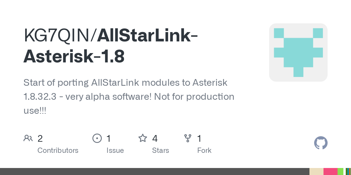

No one has stepped up to the plate to "patch/fork/whatever" app_rpt to
the later versions of Asterisk.
I will just leave this right here for now.
This was done back in October/November 2015.
It is Alpha level code at best right now. The core app_rpt functions, I
cannot guarantee that anything else does.
The reason that nobody has done it is both that it is a major
undertaking, and that you rarely find more than one or two people crazy
enough to take it on. The reason for it being a major undertaking is
that, the higher you get in Asterisk versions, the more significant the
changes are from 1.4.23pre.
