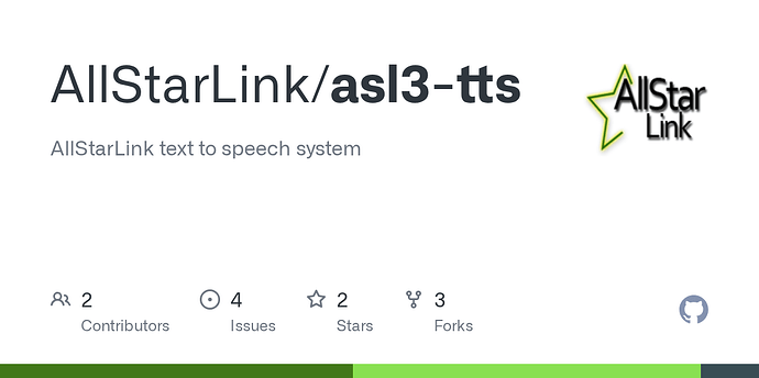

Please open this as a feature request at GitHub - AllStarLink/asl3-tts: AllStarLink text to speech system. I'm going to be doing a big update at some point for asl3-tts so it works a lot better. I'd be happy to add this.
