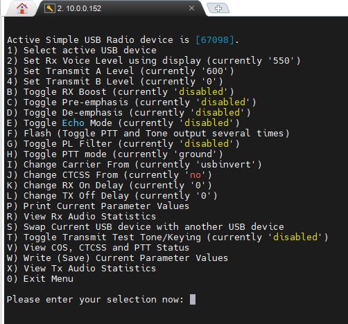

Are you entering w before exiting the tune menu to save the parameters?
Thank you for replying. Yes, a W then a 0 (zero).
This thing is driving me nuts. I would think that Asterisk would “restart” with each boot, so why it would start up bad, then need an Asterisk restart completely baffles me.
