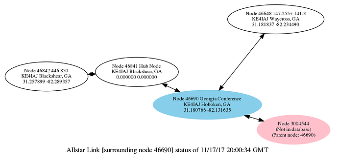

Node 46841 is a hub node running on a Raspberry Pi Zero W. I am monitoring the CPU, RAM, and other resources, which you can see below. Also see bubble chart below. It’s connected to hub node 46690 which is permanently connected to the Echolink Georgia Conference with many linked repeaters throughout GA.

I have no idea how many nodes the Zero W can handle but at the moment I have 2 connected and it seems to be handling it fine for now. At 8:00PM EST tonight there will be a tech net that will last over 2 hours, which should be a good test for it.
