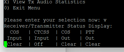

To add some background I had asked OP in an email, “Is ASL showing that it sees COS in the tune menu command that shows COS and PTT? If you command it to send test transmit (flash tones) from the tune menu does that work?” but Josh replied that wasn’t sure what that meant, and had been using ChatGPT which had come up with some “interesting” but not useful responses.
To elaborate on my question, you want to run asl-menu, which can be done by logging in by SSH and then running ‘sudo asl-menu’, and then run the tune menu option there. You will then see options to display COS and PTT status, and to transmit test tones. If you can post the results of those tests here that should help start to narrow down what’s going on.

The blue light blinks only when a local HT is transmitting to the node. About 3 seconds after I stop transmitting the blue led goes to solid… not blinking. I have not changed the USB port since imaging to PC. let me know if you want me to start fresh and record the whole thing (probably not debian install)

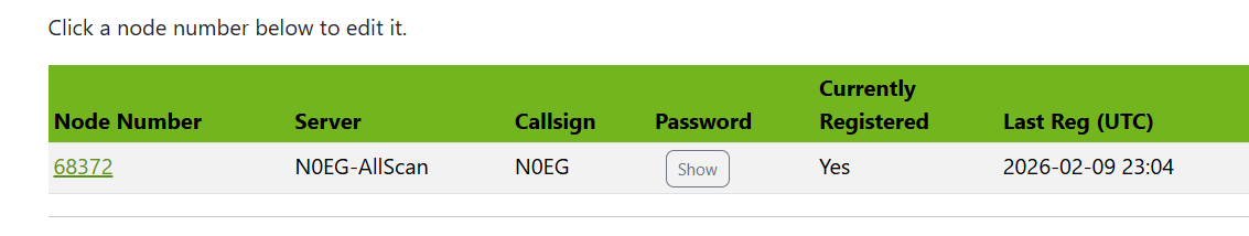

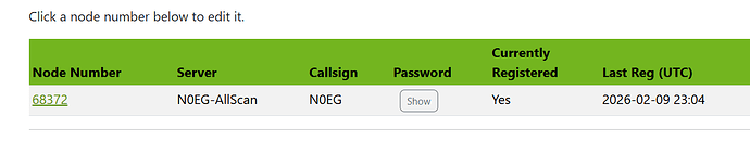

Rebooted the system… no change in status… Visually the Blue LED is solid. If I key a handheld on the rx freq the COS LED glows. Stops when I stop transmitting.
the dashboard shows it registered after the reboot.

Based on the above you have a very messed up system. At minimum it looks like your filesystem is corrupted and you're missing the DAHDI kernel modules.
I would suggest starting clean from a fresh install and use only standard ASL3 tools to configure the node. Get that working and then you can add in other stuff like Allscan applications.
Hmmm... I wonder if the DAHDI issues are due to your PC having Secure Boot enabled. We have some information @ ASL3 Manual : UEFI and SecureBoot but the quick/easy test would be go to the shutdown the system, startup in the BIOS settings, disable Secure Boot, and then when booting back into the OS check if asterisk is behaving any better.
But there's other errors in that log too. Problems resolving hostnames, that segfault backtrace, etc. None of that is normal behavior. Speaks to a wider system corruption issue.
Thank you all for your help. I disabled secure boot, wiped and rebuilt the system. Same results. New Logs do look better??? see some DNS errors but the status screen shows “registered but not reporting statistical data”
