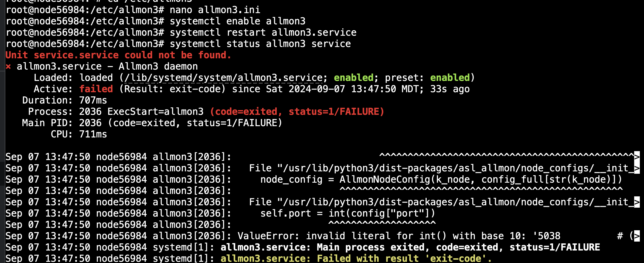

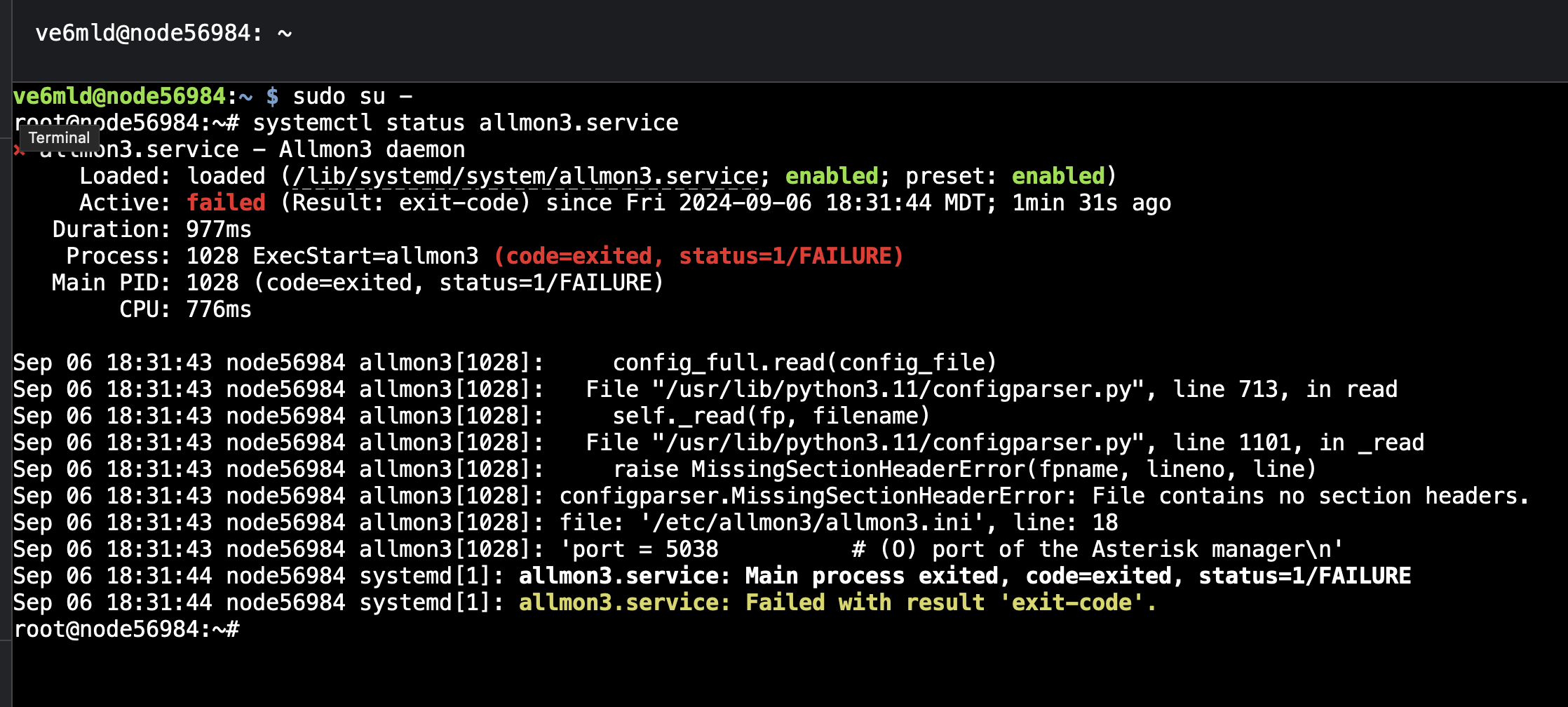

I tred to restart:systemct restart Allmon3.service, then i did systemctl status allmon3 .service and got these errors
You have corrupted your /etc/allmon3/allmon3.ini file.

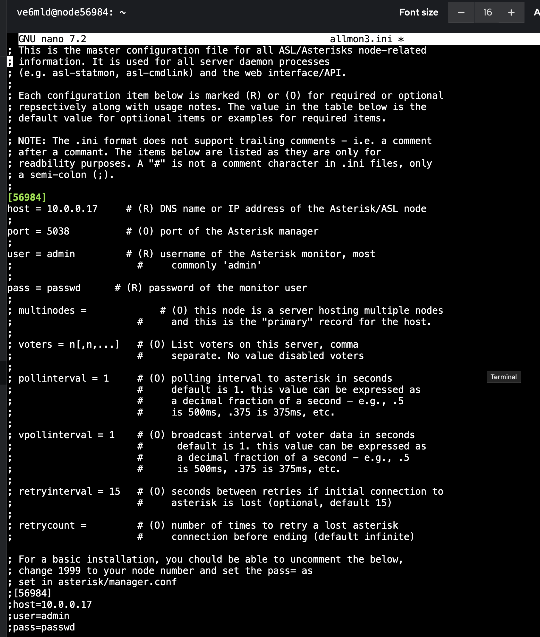

What does your /etc/allmon3/allmon3.ini look like? You still have something corrupted.
You edited the documentation part of the file. The .ini syntax doesn’t support trailing comments.See the information right above where you put [56984]. Re-comment all of that out and then put your read config at the bottom of the file as shown.
[56894]
host=10.0.0.17
user=admin
password=.....

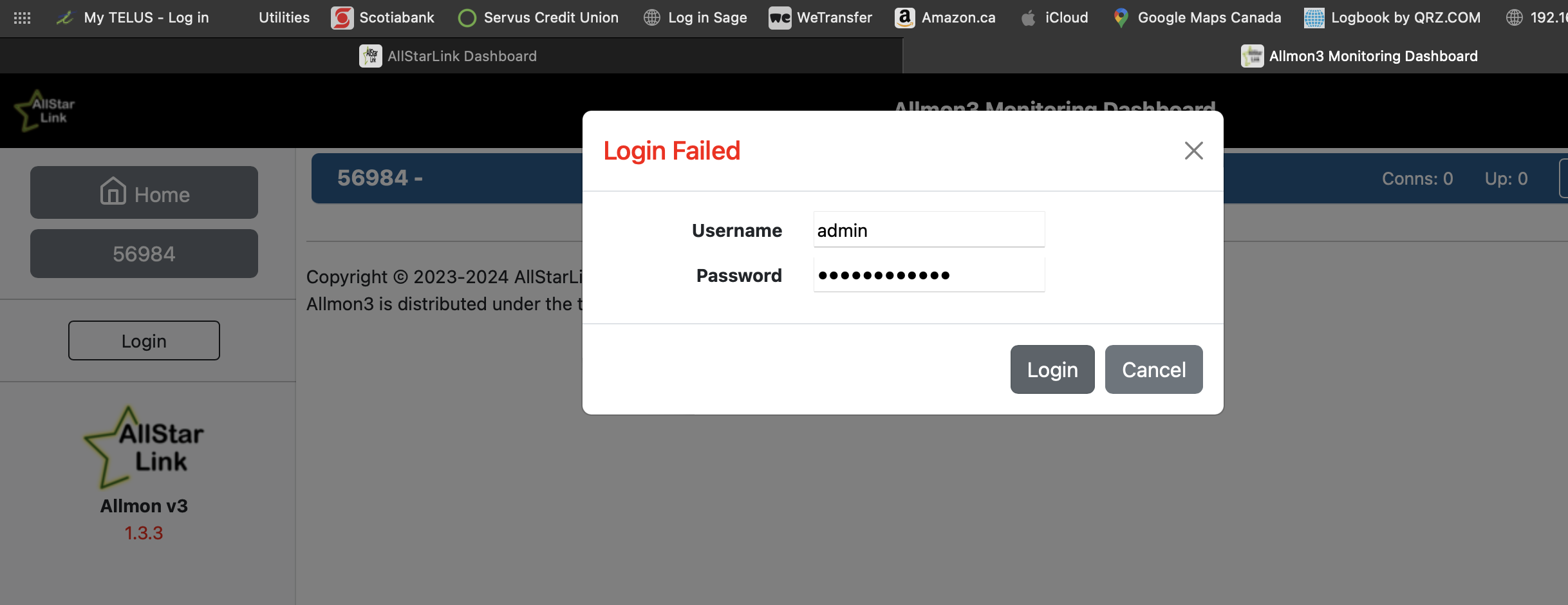

Did you setup an ‘admin’ user? This is all covered in the manual:

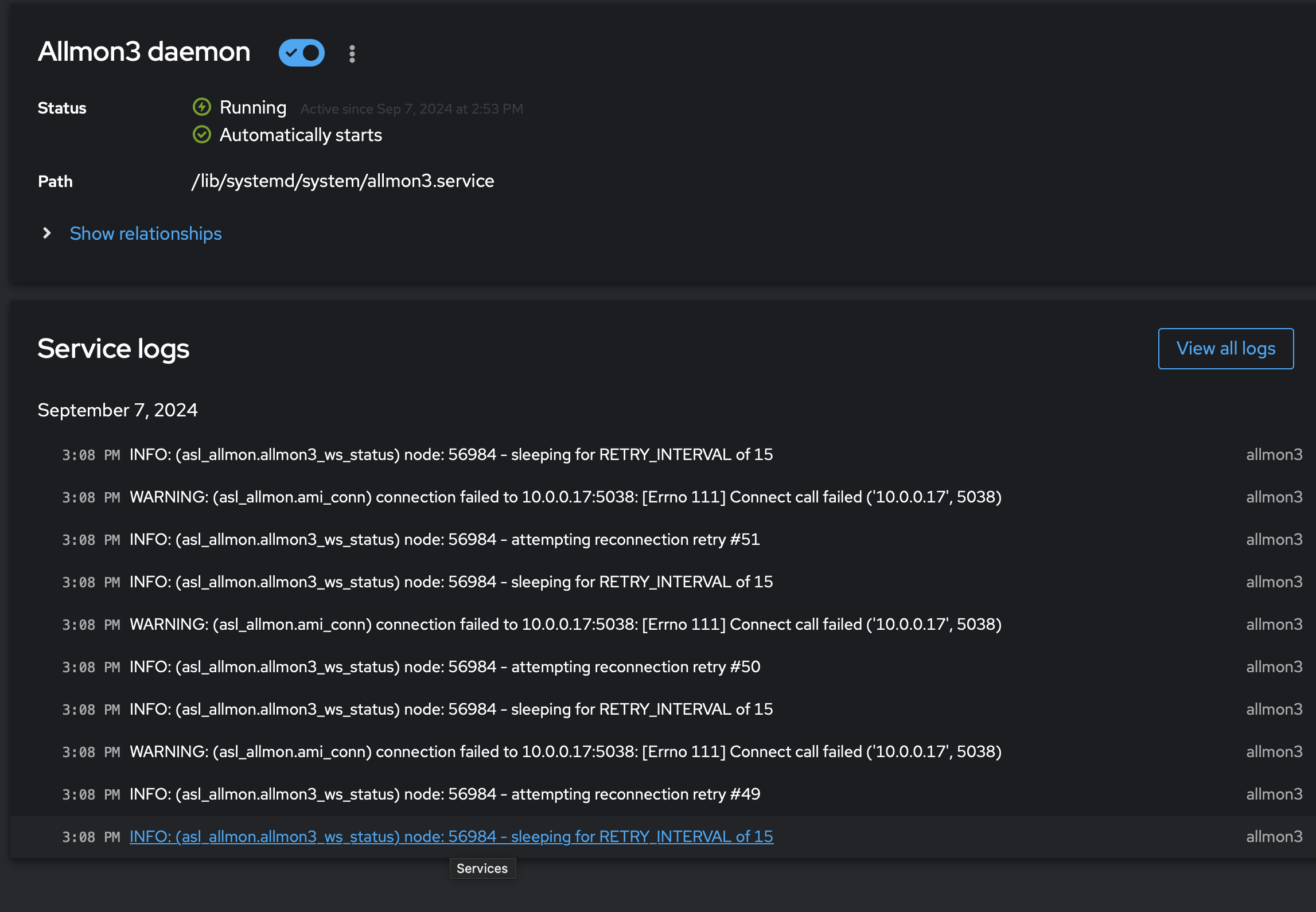

Your configuration in allmom3.ini doesn’t match the configuration on the other host’s asterisk configuration in its manager.conf.
