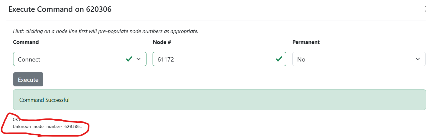

but when I attempt to connect to another node I get this error
It says command successful, but at the bottom it says this:
Unknown node number 620306

It means your local node is configured incorrectly. The app_rpt module is not running a repeater for node 620306.

That message is misleading in this context. It means that the command was successfully executed not that whatever the command did what you expected it to. There’s no reasonable way to assess each command execution for “did what you expected it to” which is why the output from AMI is directly and fully displayed. You’d see the same thing if you ran that from the Asterisk CLI.
